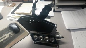

Ordered my PPP shifter today. Spoke with them on the phone went through all the options, great customer service. Going to take a few weeks to get it, they are swamped. I’ll post some pics when I get it installed. Anyone that’s running the PPP can you post a pic of your interior, thinking about making a mount for it. Thanks
I have one in my Challenger. I like the slim profile of it. Mine is front entry for a reverse manual vb.
