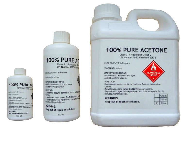

I'd be careful with the acetone, it doesn't get along well with many plastics!
True, but it's just a quick wipe. And some plastics aren't affected at all, like for instance the bottles that acetone is often packaged in. :)
The bottles are HDPE but most automotive plastic is ABS or PVC and they don't like acetone. A safer choice is wax and grease remover.
Sure it does. You can glue them back together after making a slurry once melted!!
