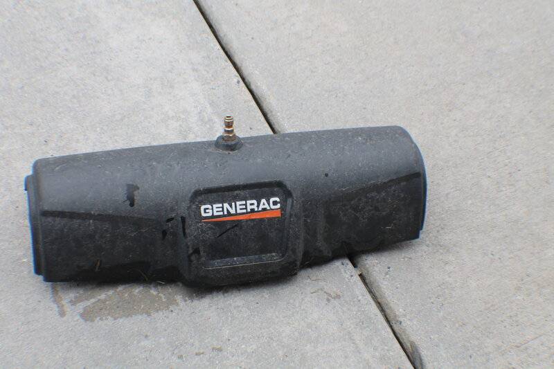

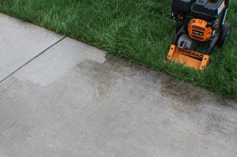

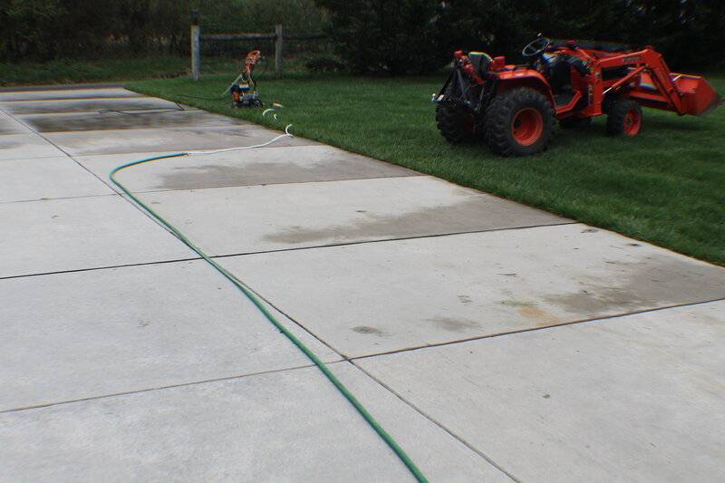

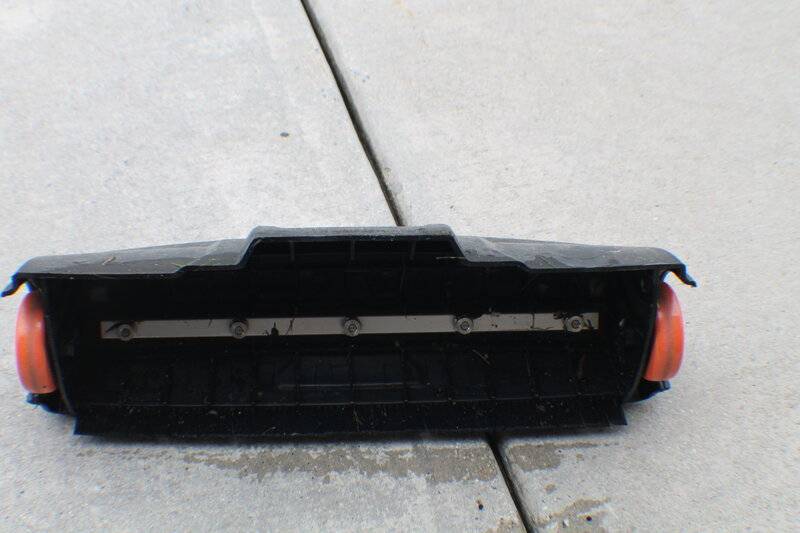

6" 4000 PSI 18 years old and only the 2nd pressure washing.
Needs sealed when I get er all done, 3rd day tomorrow.
Generac multi just does not cut the surface enough.
I went over the whole drive way "2400 sq.'" with it.
Then 3"s at a time with the high pressure cutter.
Any suggestions for a good concrete sealer, for concrete 18 years old?
