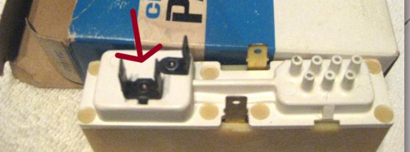

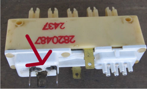

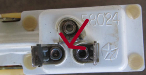

I've also looked at '66/'67 wiring diagrams and '68/74' wiring diagrams and noticed the wiring for these switches are pretty much the same. BUT look at the 3 pin connectors (see the photos). On the #2587564 the 2 pin is connected (like a jumper) where on all the other switches the 2 pins are separated.
Therefore, here is the question. Are these switches interchangeable? If so, you will be able to replace your '66/'67 switch for a fraction of the cost. The later '68 to '74 switch can be had for $50 not $400 for the #2587564.
Any definitive information about these switches would be greatly appreciated. I'm loosing a lot of sleep thinking about this. 2820487.jpg2820487 pic 2.jpg2587564.jpg

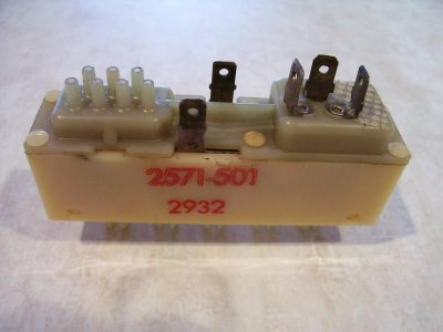

i've got this one that i'm not using. it's NOS.

If you look at the pics I put up showing the pins in question, those are the pins we are talking about. I have figured out that on the 66/67 switch the pins act as nothing more than a jumper. Either side is a feed and the other side has no actual wires go to/from it. On the 68/74 that pin is split. One side feeds the controler and the other pin - I believe, looking at the wiring diagram - feeds the fan switch and supply's power to the fan when the key is turned on so the fan comes on automatically. I have purchased a 68 controller and plan to disect it and compare it to the 66/67 switch and answer this question. My beiief is you will be able to sub the 68 controller for the 66/67 by simply leaving one pin disconnected and protected with shrink wrap. PLEASE DO NOT DO THAT ON MY SUGGESTION. I DO NOT WANT TO BE RESPONSIBLE FOR AN ELECTRICAL FIRE IN YOUR CAR. These are simply my thoughts on this subject and I'll report what I find when I disect the 68 switch.

Unfortunately, I have not found a solution. I have dissected a 68 switch and they are different from 66, 67. There is a guy in Texas who rebuilds them. He does a good job and is reasonable. This is his contact info, hope it helps ANTHONY POWELL <[email protected]>
