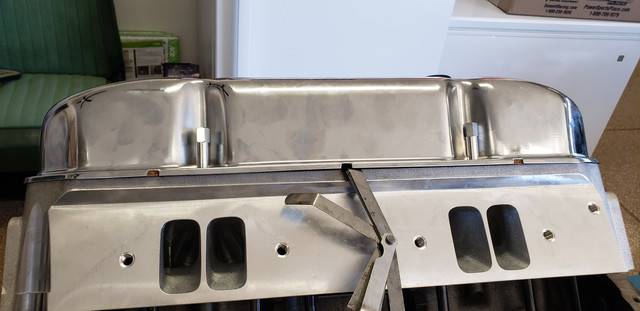

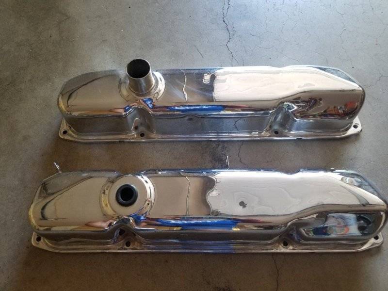

I got a pair from Summit this week. The older cast bog block Mopar Performance valve covers are no longer produced which is a shame.
The bolt holes had to be opened up to fit. Had to move the lip out a bit in a few places to get over the gasket. Then after snugging it down I see this. The upper part of the cover warped so bad I can reach in and move the gasket around. That was about .070" of feeler gauge in there with room to spare. The other cover was not as bad, but still unusable.
.070 clearance...wow that sucks balls. Major oil leak waiting to happen.
The Mopar Performance valve covers I have needed some work also. Since I needed to machine the holes for the grommets I figured I would set them up on a mill and run a endmill around the gasket track.. wound up taking about .015- .020 off to get it flat enough to use. China castings are not bitchen by any stretch...but .070 is a lot to clean up...
Good luck with that :thumbsup:
I assume from your photo those are stamped parts, not cast ones. I'm at a loss as to what can be done to make them usable. Certainly machining on cast ones is workable, but yours appear to have a problem with the dies if the center is pulling up that much. I've always understood when stamping they have to push beyond the desired final shape some to get beyond the 'memory' of the material.

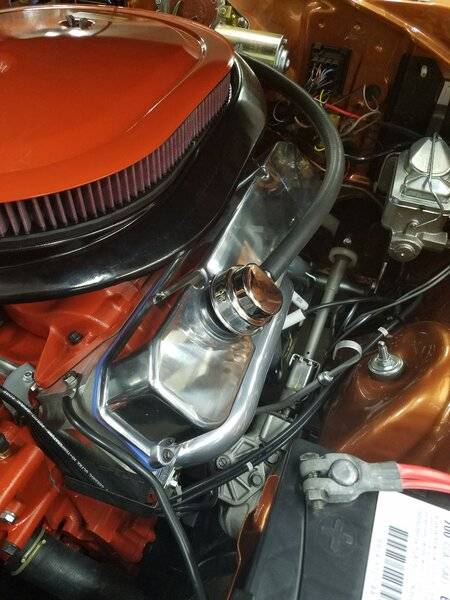

I bought these Summit brand along with these gaskets and no leaks. I think the covers were around $100.

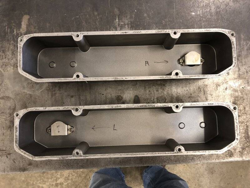

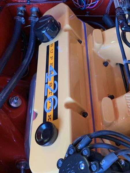

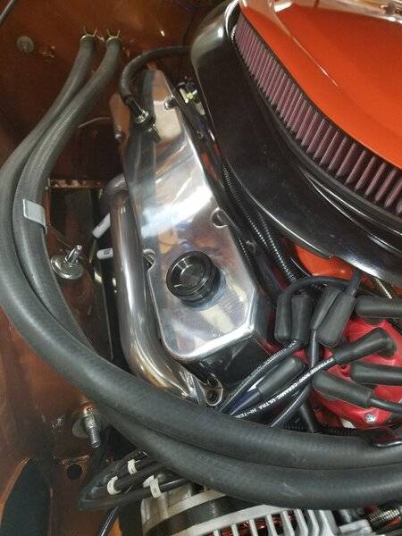

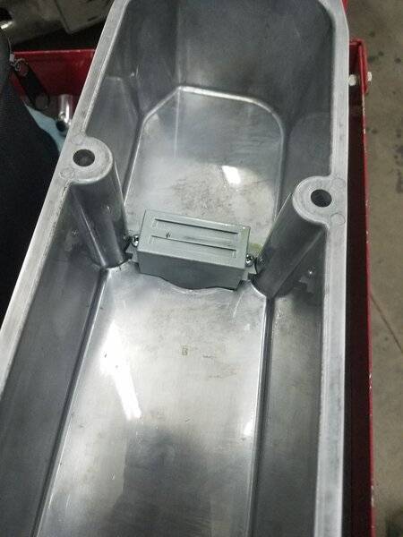

Yes, they have a baffle under both the pcv and breather holes. I added the black oil fill port on the passenger side.

I got mine from Todd at Marsh Performance (MOPARTS@PTMC.NET). Very happy with the quality and sealing. Baffles are included. Like Elk, above, I installed an oil fill cap from Speedway.

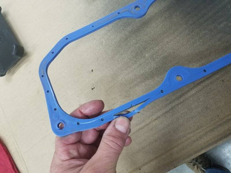

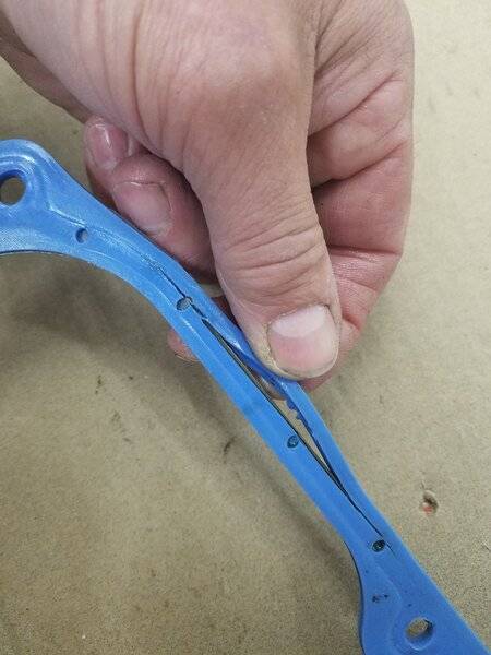

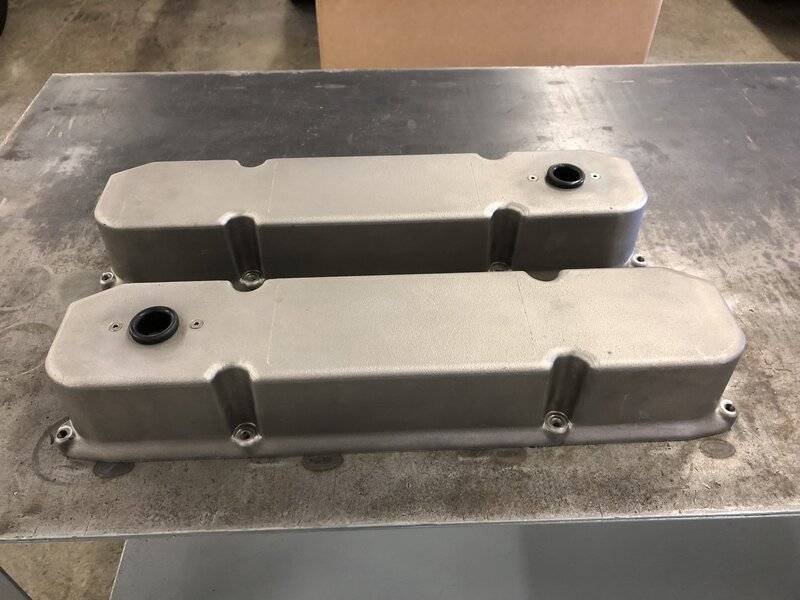

Got to update my post. Put about 100 miles on the car yesterday. All of a sudden I had an oil leak on the rear passenger side valve cover. Just took it off and found this :BangHead:.
Also here is a pic of the baffles in these covers.

Ahh yes. The Moroso gaskets are great but they must be used with a flat surface and just snugged--not tightened much at all. I've torn them with what I thought was nowhere near enough torque on the bolts, but it just takes enough to just put a little squeeze on them and they'll seal fine. It looks like your covers have a flat rail so you should be good there.

Yeah the Moroso gaskets will tear unless they are installed on perfectly smooth surfaces. Basically the only way they work is if you have aftermarket heads with a machined rail and cast covers with a smooth rail. Then they work pretty well. If you have cast iron heads you might want to stick with a fiber gasket like the Fel Pro thick black one. I don't use the Moroso gasket on anything anymore. For my "perfect" situations I use the Cometic gaskets. Zero leaks with the Cometic gaskets but they need a nice smooth valve cover rail to sit on.
I have Trick Flow 240 heads. Had the Cometic's on first and they leaked in the exact same spot. The engine builder called Summit and was told they recommend the Morosos with this combo. You think I should try another set on them?
I've never seen any problems with Trick Flow heads. You need to carefully inspect the valve covers for size as well as flatness. Turn the valve cover over and lay the gasket on it and see how it fits. Then do the same with the head and see how it fits. Those valve covers must not be the correct width if they are tearing the gasket on a Trick Flow head.
Which Cometic gasket did you use? They have a cheaper fiber gasket but the good gasket is the rubber molded on a steel core. I've never seen them leak on a Trick Flow head if the valve cover is the correct size and is flat. I have Cometic gaskets on the engine in my Duster and the valve covers have been on and off dozens of times over the years. Zero leaks even though the gaskets have been on the engine for several years.
