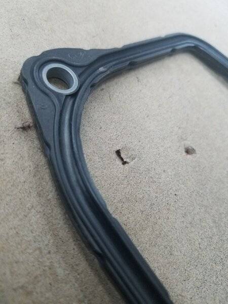

Not sure what the model of cosmetics is because they were bought and installed by IMM Engines. Here is a pic of them. They are pretty robust and I am sure there is metal inside them. The back bottom corners are where the problem seems to be. I heard that the Trick Flow heads are slightly narrower than other brands, idk if this is true.
I don't know what the problem is that you're having but I'm suspecting something isn't correct. Take a look at this article. I used TF heads and Cometic gaskets and I had the valve covers off dozens of times as we changed rocker arms multiple times. Zero leaks from the valve cover gaskets with dozens of WOT dyno pulls. Either your heads have a defect in the rail or your valve covers are warped. You just need to inspect everything closely.

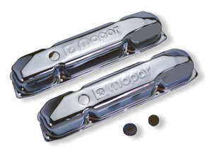

When I did my valve covers (Mopar factory chrome dealies from '67) I wound up using FelPro #VS50145R
gaskets. They're reasonably priced, tough and rubberized for repeated VC removals.

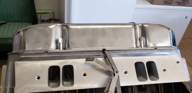

I got a pair from Summit this week. The older cast bog block Mopar Performance valve covers are no longer produced which is a shame.
The bolt holes had to be opened up to fit. Had to move the lip out a bit in a few places to get over the gasket. Then after snugging it down I see this. The upper part of the cover warped so bad I can reach in and move the gasket around. That was about .070" of feeler gauge in there with room to spare. The other cover was not as bad, but still unusable.
Geeeez! They would be headed back. I can't accept spending good money for bad parts.
