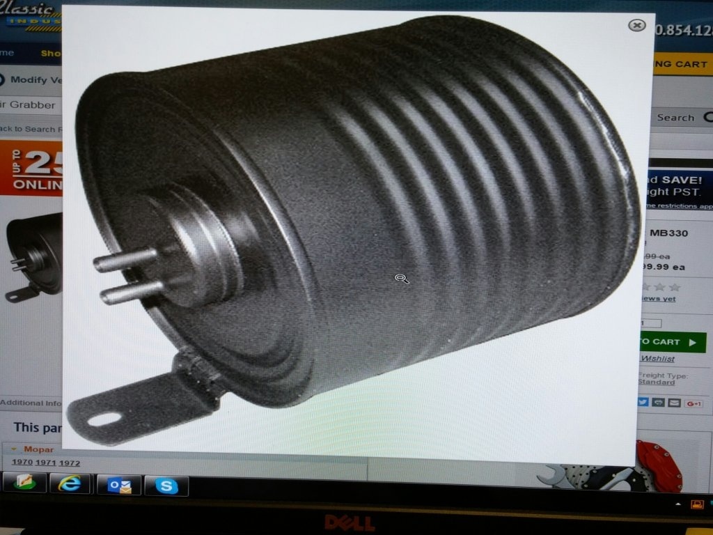

I have seen 2 types of canisters one has ridges like the photo below
and the one i have is all smooth, do you know which one is correct?
