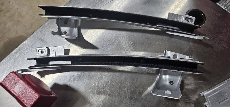

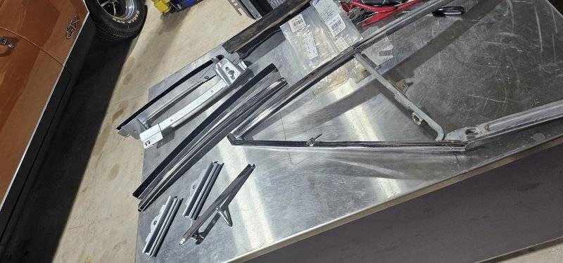

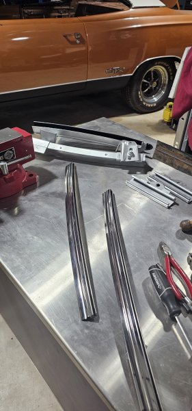

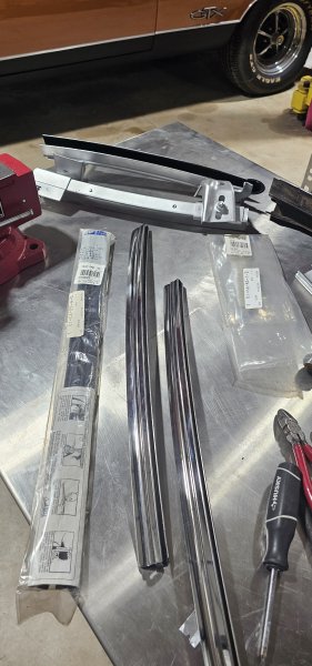

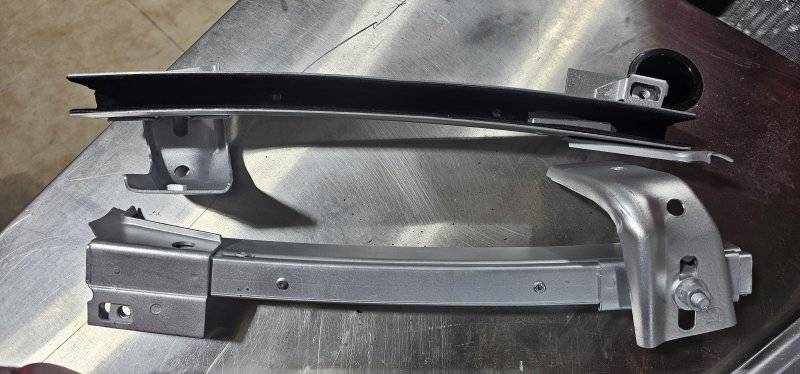

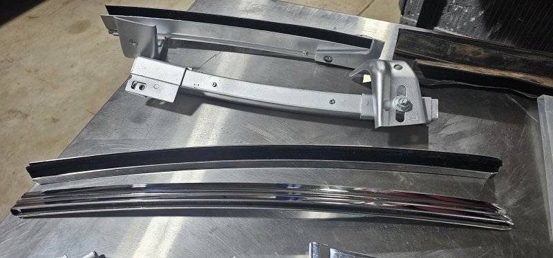

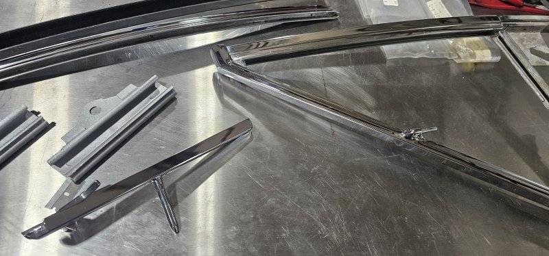

I wish I had taken some before and after pics, but very happy with how my window trim in coming out. I hit the chrome and stainless with my buffing wheel and took my time on them. They were fairly rough to start, but fortunately very little to no pitting. Also sandblasted some of the inner guides and hardware and gave them a coat of OER galvanized paint. New felts went in fairly easy. Working on the original glass next. Will be compounding and polishing to see how good I can get them.
Looks great!
What product are you going to use on the glass?
Going to try some higher end Meguires compounds first. Try to get rid of some of the heavier scratches best I can. If that does not do the trick I will buy some of the products designed for glass that contain Cerium Oxcide.
