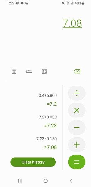

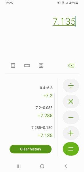

This is what I came up. With for adjustables with cup/ball pushrods.
Closest pushrod length I found is 7.342

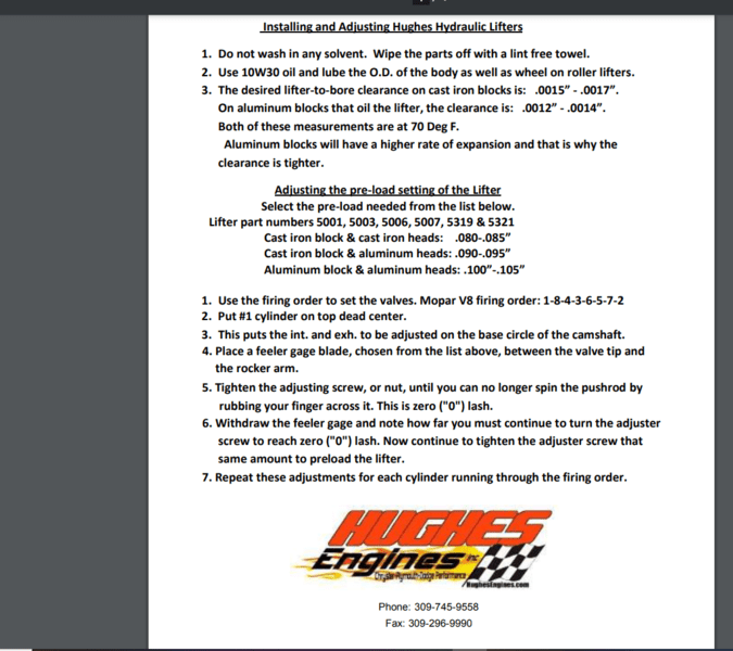

Two different hydraulic. Lifter preload. Everything I have read says 0.020-0.040, but hughes says there lifters are 0.080-0.090

here is what i came up with for the adjustable 273 with Hughes hydraulic cam
6800 length pushrod collapsed
8 turns out @ 0.050 plus 6.800 equals 7.2
plus Hughes lifter preload of 0.090 plus 7.2 equals 7.29
minus 0.0150 for cup gives me total length of 7.14
does this seem correct...i found proform pushrods 66417c with length of 7.190.. these should work

here is the sheet from hughes.. i have cast block aluminum heads and lifters #5001 it says 0.090-0.095 preload
