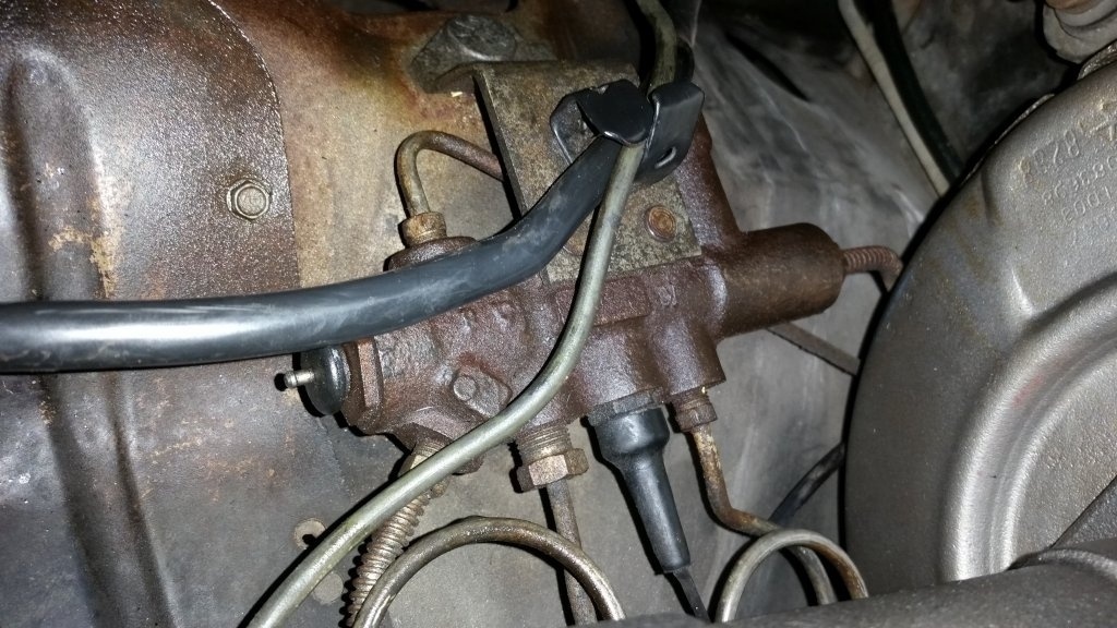

Can you take a picture and post?
They were available new repro sometime ago of the K-H one, not the bendix though ( the pictured is K-H ). Bought one, but just last long 2 years and began to fail like my old original one. Dunno if bad luck or bad quality. When installed worked GREAT untill failed.
There is rebuild kits around with springs and O rings available, but the front section of them.
It seems the repro piece is not anymore available, so mostly sure what I got is a quality issue and they weren't made anymore
3642 233 is the part number
PF527 Is the number they show next to my part in the manual.
First, you do need a prop valve. Second, you would most likely be OK grabbing one from any 1973+ Mopar rwd passenger car at the junkyard, up through the 80s diplomats.
