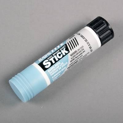

excellent thread.. I did a front disc brake swap on my dads 70RT using MP's brakes. They did not supply a new proportioning valve. But I noticed when you have your foot on the brakes you can hear a lot of chatter from the front calipers.. Can this be because I need to install that combo valve???
Did the kit you got from MP come with a replacement distribution block darkhoarse? Some MFG's supply a distribution block with a non-adjustable proportioning valve already intergrated inside.
As far as your issue, did you apply some anti-Chatter/squeek (pic below) to the back side of you pads when installed them? If not, usually it's the first thing to remidy any chatter down there. Easily found at most auto parts stores. As far as it being the proportioning valve, not likely. The proportioning valve is used to control the amount of pressure to the front/rear brakes (typically rear-some cases, both). Drum cars did not have them. Issue's with not having one or having a faulty prop valve= rear brakes locking or hard rear momentum shift in braking or hard front braking, excessive shift to the front during braking, over sensitive pedal.

Thanks for the advice. No the MP kit did not come with any dist.Block..Should I start there? thanks for tip about the ant-chatter stick..cool
No sweat darkhorse......Try out the anti-chatter, guessing it will do the trick for you. Apply a liberal amount to the inside pad where it mates up to the caliper piston(s) as well as to the backside of the outer where it meets up with the caliper.
