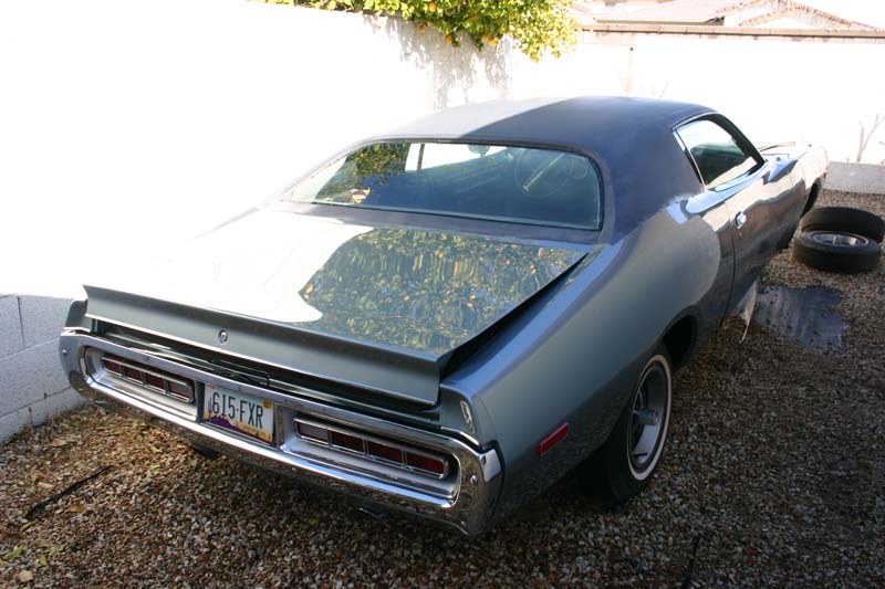

During my stay in Scottsdale for the O7 Barrett Jackson event, I found this car in the local paper. It was an original, rustfree SE that a guy had just lost interest in. He had redone the interior, painted the car, rebuilt the engine, tranny, new frontend, brakes, etc and simply stopped. It has sat in his back yard for several years untouched. It was love at first sight for me, I had missed out on one of these when I was in highschool. A friend had one for sale and I could handle the $1800 asking price but could not deal with the $900 yearly insurance cost. Strangely enough, back then a 72 400/4v was considered HP???? Right, all 220 hp....lol
Anyway, I had always wanted a 72 SE after that and I just had to have this one once I saw it.
It was absolutely rust free and somehow has never had any body damage at all, great starting place and I figured with the new paint and interior, I would simply hook the rest of the parts up, and be driving in a month, right? Wrong.

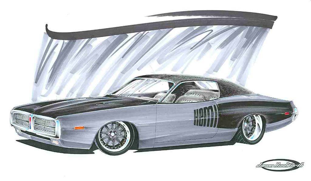

First thing I did once I decided to go over the line with the car was have a friend of mine, Jason Rushforth do a rendering of it.

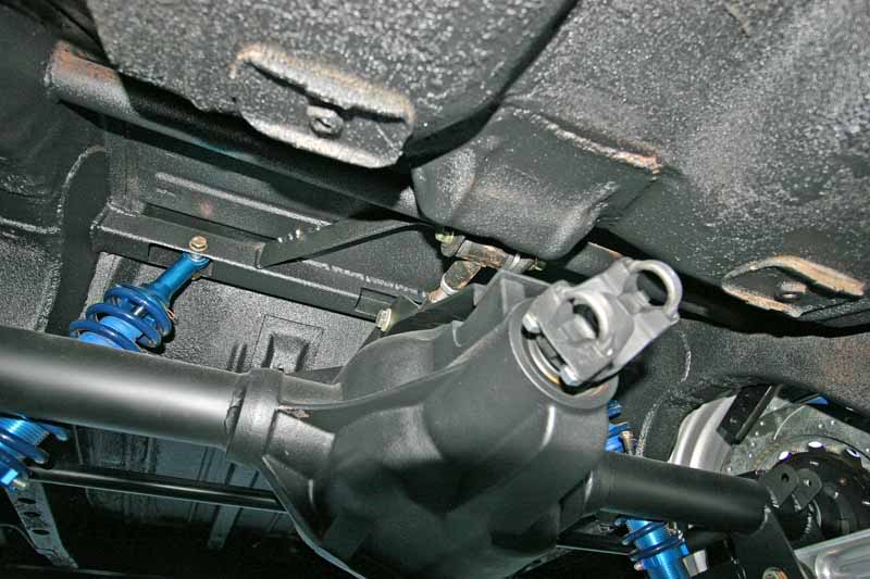

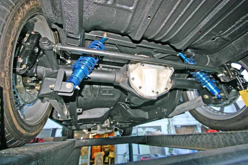

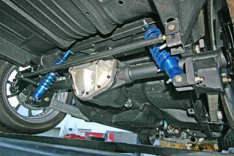

Next, once the XV parts arrived we worked on all the required welding and fitting to get the frontend installed then moved on to the rearend. When we bought the rear setup, we knew they were not designed for a third gen, so we basically took the parts, cut them up and built our own three link setup.
Very nice car, and the rendering is very tight! Does your friend do renderings for $$? I am in need of some renderings for my GTX, ideas?
There are several great rendering folks out there. If you go to my website I have a section just for them to show off their work. The cost varies, just check with them, there will be links to their contact points.

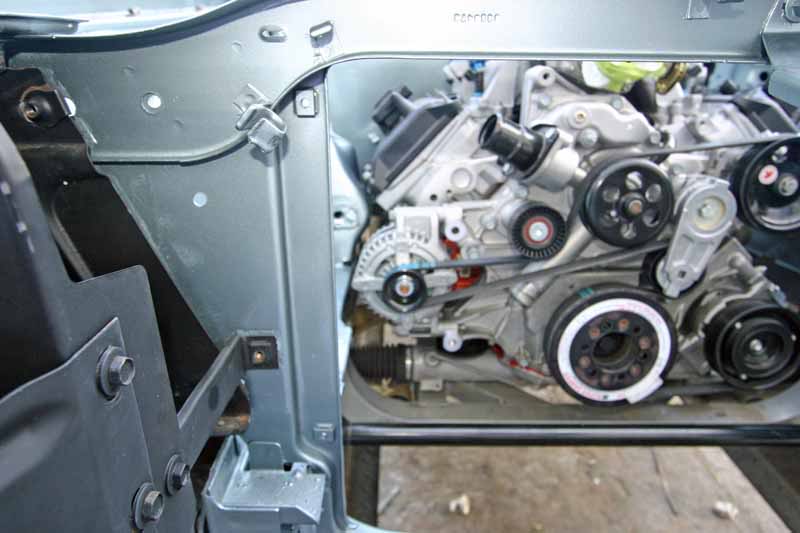

Here are some pictures of the frontend when it was shipped to me. It gives you an idea of how much time went into the design etc by XV
After the front and rear end pieces were installed we moved on the the drivetrain. I scored a 6.4 392 crate motor early on, if fact it is one of the first ones offered to the public. I have done alot of business with Mark and Street and Performance and this was the first one he got his hands on.

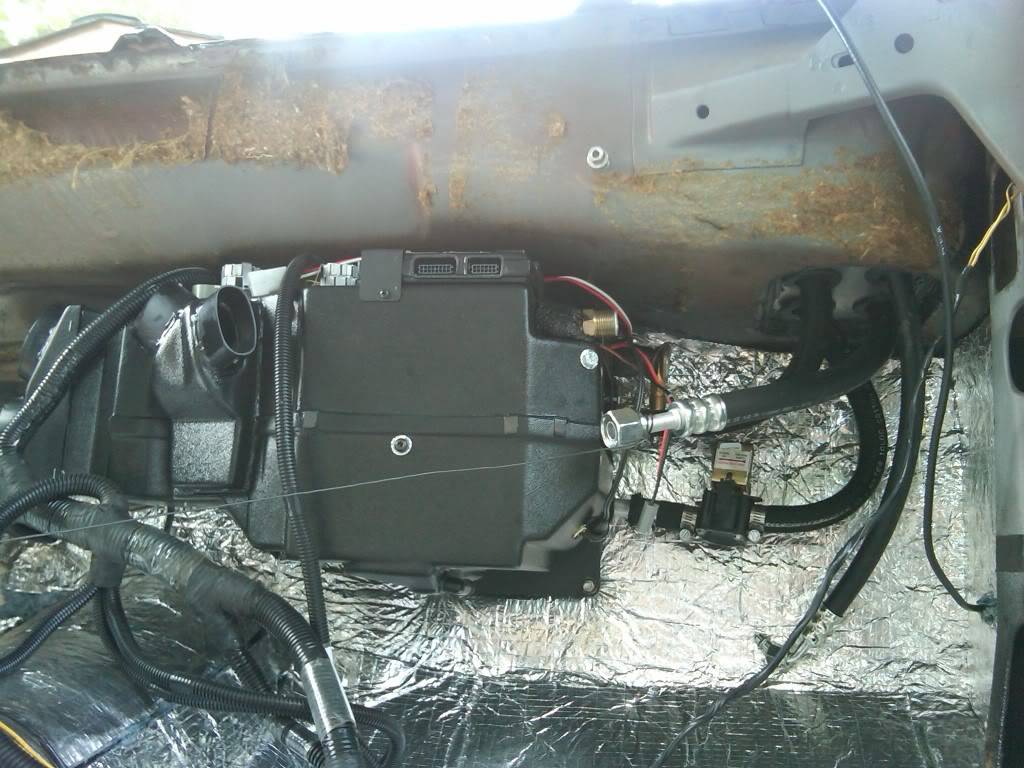

Then it was on the the time consuming part, like Vintage Air, and how to make it fit.

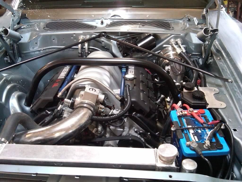

All the parts and pieces under the hood.
That brace you see is for real, really strengthens things and really ties all the XV bracing together.
Notice where the heater hoses and A/C lines come out of the firewall. They are in the tray where the wiper arms are. We cleaned up the firewall since the factory holes did not work with the vintage air setup.
BTW, all acc. on the engine, compressor, starter, alternator, etc are straight from Mopar. If I have a issue I simply go to the nearest dealer for help. Not sure how their computers will tell them the part I need, but they all are marked...haha.
Sweet, thanks for showing the pics of the XV set up as this is what I have in mind for my Bacaruda. How was customer service from them? I've heard guys complain about it over at abodiesonly and would like other opinions, too.
I can not complain about their customer service. Going into this project we all knew that they had not ever done a third gen b body. the front worked out right, absolutely no issues there. The rear was different, because fitment just did not work out with the third gen. I finally gave up on their subframe connectors, and made my own. The rear set up was close but we did have to modify things a bit. They were with me the whole way though and helpful when there was something they could do or fix.
