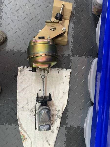

I’m converting my all around drums on my 71 Charger to front disk, rear drums, and removed my master cylinder for restoration or replacement.
Question, can my stock master cylinder be used with the PST power assist unit, or do I need to buy a new master cylinder, and which/where?
Or, do I not need the stock master cylinder with this?
PST booster details.
"DBK DOD623"
The booster is an 8" dual diaphragm with bracket and non-adjustable rod. The master cylinder is a 1 1/6" bore size, dual reservoir.
Thanks!
The kit that you are referring to "DBK DOD623" use a 2 bolt master cylinder and booster . Do you have a booster from us or are you looking for a a booster? We should be able to help you.
Thanks
James From
PST
