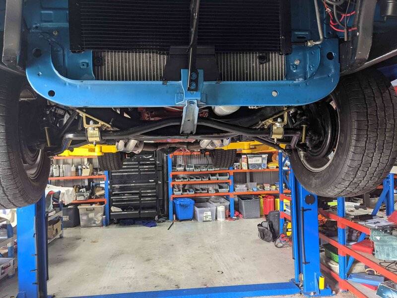

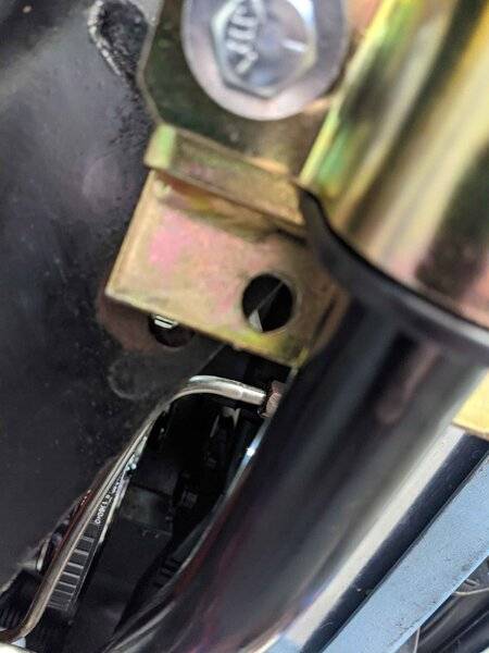

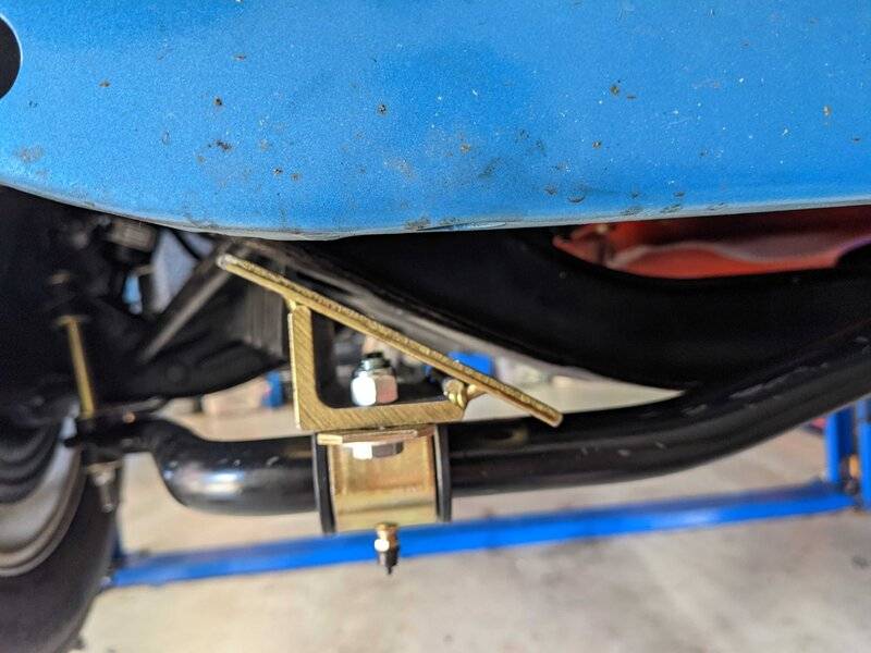

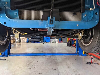

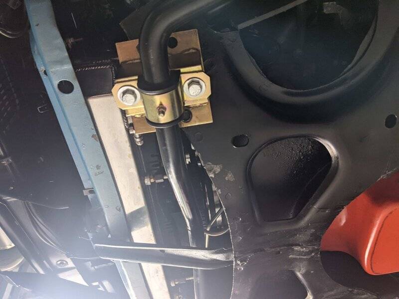

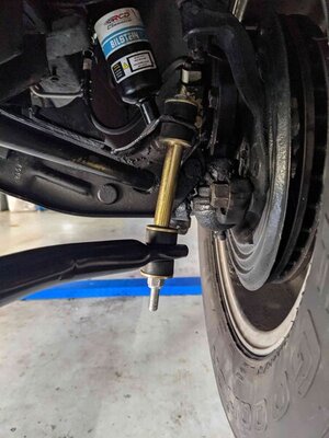

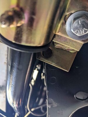

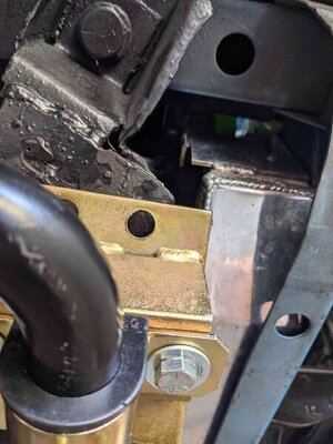

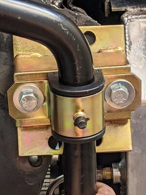

Hello all,
I'm fitting a PST front sway bar. My car already had a sway bar. I'm having a problem lining up the holes of the mount to the edge of the K member. The outermost hole of the mount doesn't line up enough to screw into the edge of the K frame as pictured. The mount is pushed all the way backwards in the slots of the clamp. I tried full load, half load and no load on the wheels but it didn't change anything.
The only solution I can think of is slotting the holes of the clamp with a dremel to be able to push the mount further back.
Any ideas?
PXL_20211021_063913667_compress93.jpg PXL_20211021_063923929_compress96.jpg PXL_20211021_063928978.MP_compress73.jpg PXL_20211021_063940645.MP_compress55.jpg PXL_20211021_064112097.MP_compress21.jpg PXL_20211021_064123543_compress3.jpg PXL_20211021_064130164_compress81.jpg PXL_20211021_064134869.MP_compress3.jpg

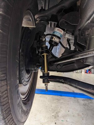

You sure you're not just fighting the fact that you already have the links in place. They should be the last thing hooked up...
That's a good idea. I'm just afraid that if I do that there would be binding. I'll hold it in place with clamps and see how I go.
The link ends are suppose to have considerable range of motion so I think dadsbee’s suggestion should help.
