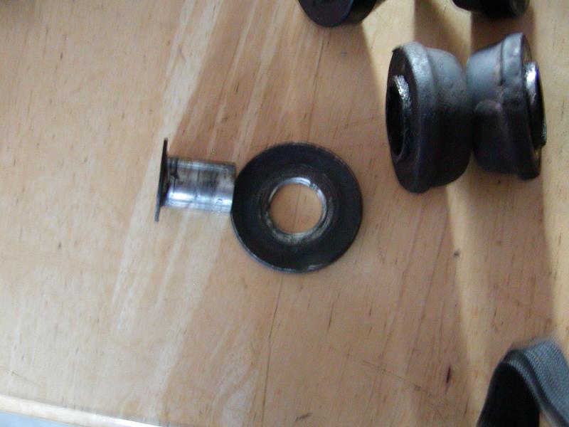

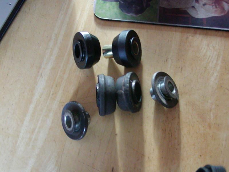

I'm replacing my old strut rod bushings with the PST Polygraphite bushings. The old style has the large washer on each end with a sleeve and collar inside which the nut threads up against. I don't see how to use it with the new bushings. Do I just use the large washer and discard the inner sleeve and collar? Or should I keep this setup and discard the PST sleeve? Thanks.

I wondered the same thing when I purchased my front end kit from PST. I optioned to replace the bushings but I cleaned & repainted the factory hardware and re used them. It just looks like a better option in my opinion.
The sleeve is to protect the strut rod from tearing up the bushings, use it!
I didn't use it. I just pushed the factory washer with partial sleeve back into both sides of the new bushings.
that's obvious, other wise you have a bushing flopping around with out a sleeve. Question is, which sleeve? Also the PST bushings are thicker so if you use the old large washer and sleeves you end up pushing the lca back out of perpendicular to the pivot shaft.
You need a washer, bushing, sleeve, bushing, washer in that order. Looks to mee in the pics above that the new stuff is missing the washers. Also the old stuff has a washer/sleeve combo, so I would just transfer the old washer/sleeve combo to the new bushings and move on.
