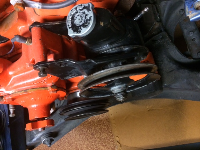

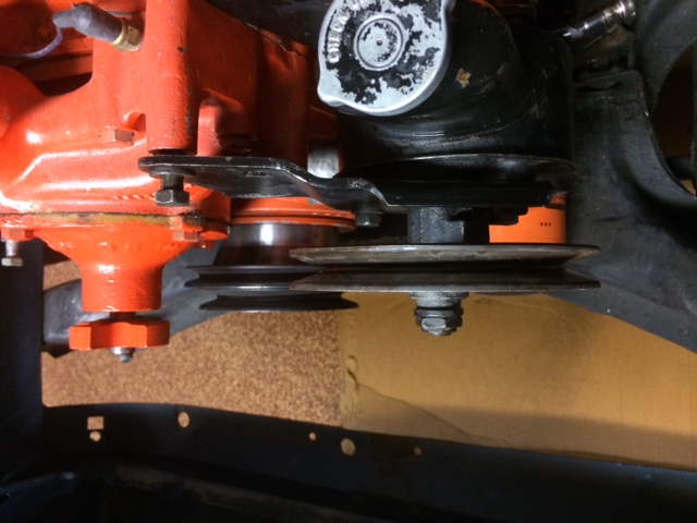

My 1971 426 Hemi Roadrunner with Power Steering: the previous owner had a 440 balancer on it so I just swapped out for the correct balancer and correct crank pulley. Now my Saginaw power steering pulley doesn't line up to the outer crank grove by approx 7/8".
Do I need a different P/S pulley? this one is not a press on style as you can see in the photos.

Looks like the p/s pulley is on backwards.
The extended 'boss' on the pulley should go to the rear, and will move the belt groove forward.
Really is it that simple? I was thinking I needed to swap out to a federal P/S unit?

It's funny, I pulled the pulley and flipped it but thought way to easy and it didn't look right but it would align
Update - the pulley turned around actually sticks out 1/2 groove to far so this wasn't the quick fix I had hoped for. Any other ideas? is anyone out there using the Saginaw pump and brackets on a 71 426 car or are you all using the Federal P/S?
