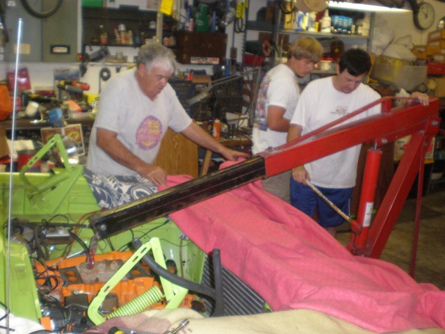

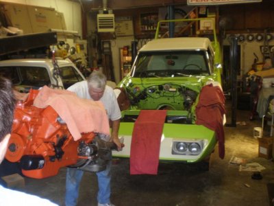

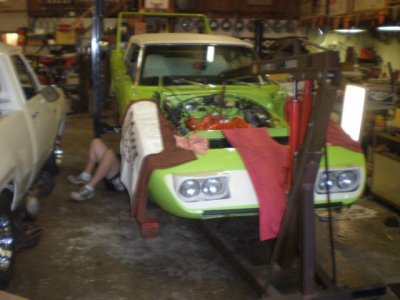

I do

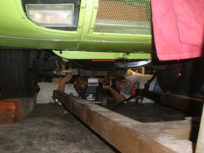

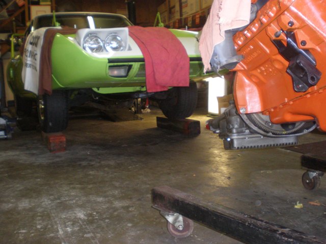

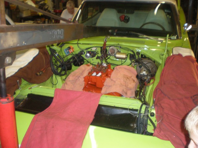

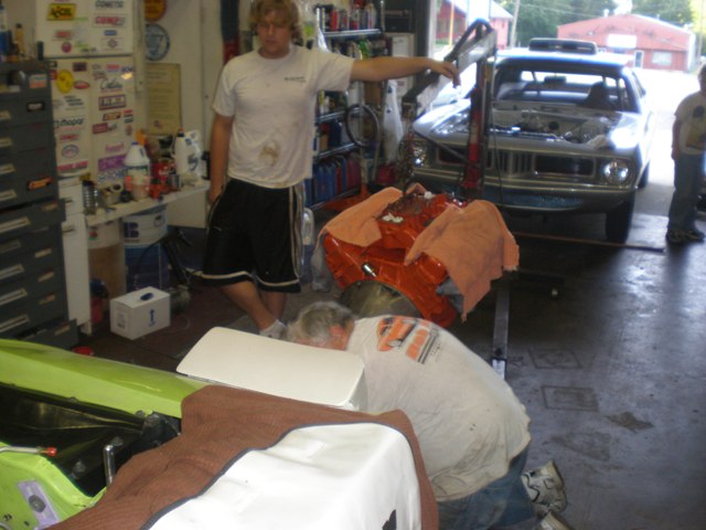

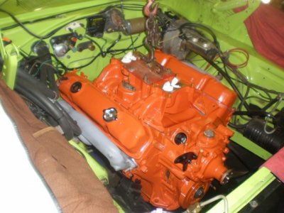

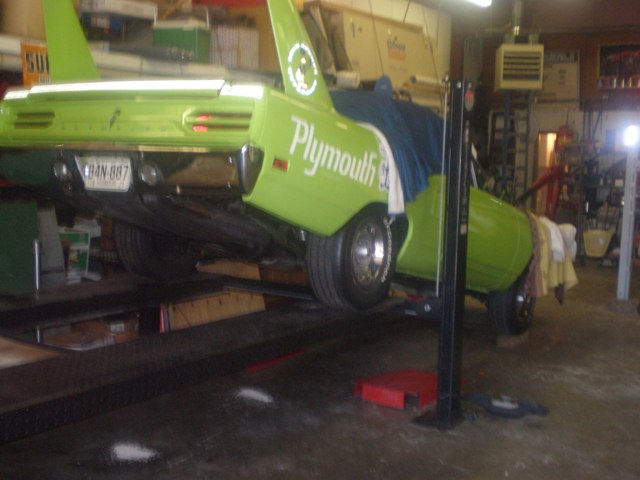

moparstuart-looking at your pictures,i never would have thought to raise the rear of the car up to pull the motor out,but it makes sense that it would make it easier to pull the motor/tranny out.i will have to try that when i get ready to pull mine out to have it rebuilt.thanks for the pictures.
Ditto!
Just did mine, I have done dozens over the years(mopars) this is the first time doing it from the bottom worked great they even make a cradle to do this, if you plan on pulling engines out in the future this is the only way to go especially if hood is on the car ect didn't even have to remove radiator.
Did quite a few. Different ways. Once you do it by lowering the k-frame assy(actually raising the body), you'll never want to do it any other way.
