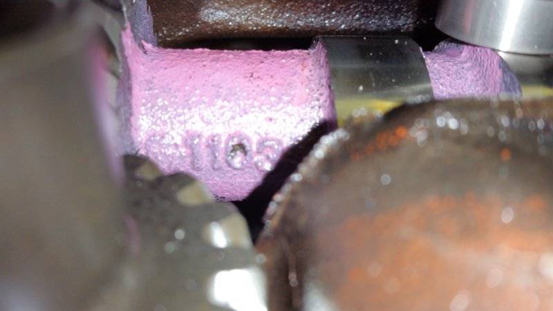

The only cast number I can find in it is this:
1103

Sound is sound. Cam design is cam design. The two ain't the same. The pic shows a casting number, not a grind #. As I recall the grind numbers are on either end of the cam.

I don't believe MP cams have any stamped or cast numbers that ID them.

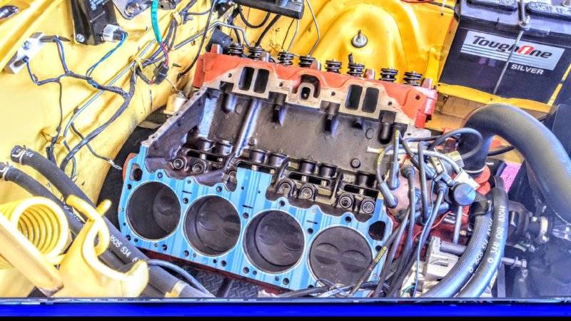

On that note, will these (presumably stock) pistons with valve reliefs AND the 78cc heart shaped combustion chambers work as far as compression ratio goes. In other words, what will the change from stock 452 1978 heads to the 78cc heads do to my compression ratio and appx what will it wind up at? 1971 440 had a 9.25:1 CR IIRC.

Here's the pic
I'm sure you are correct that a modern performance head will be a substantial increase in power compared to 452's, especially if the 452's aren't ported. If the 452's aren't milled much they'll be around 88cc. Keep in mind the true CR is the sum of many volumes, it must be actually measured and calculated. The aluminum heads want more CR by nature. A simple check with the dial indicator will tell you the lift.
So if my current CR is 9.25 :1 w/88 cc heads, what would 78 cc heads raise it to?
How do you know it's 9.25? The factors are: bore/stroke, deck height, net valve notch/dome vol, head gskt thickness/bore, chamber vol. Just a rough guess based on some estimated numbers gives me a .9 to 1.0 increase in CR going from 88cc to 78cc. All the factors I mention are variables. You need to know what each is to do the math.
