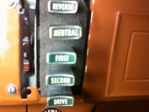

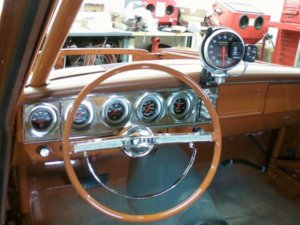

My shifter has been moved to right side and is bolted solid with no rubber so the lights work fine.
Doug
I don't mind it on the left, but the cage goes through the dash and was in the way. The bezel was a little tricky but the rest was easy. As long as i was at it figured there had to be a way to swap D/1 buttons as well. Cut the faces off and glued them in the swapped locations. Still light up fine.
