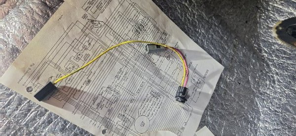

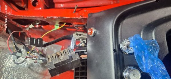

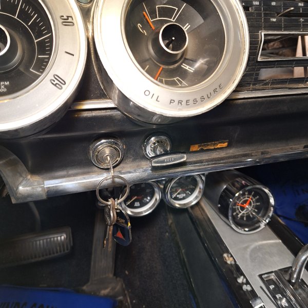

So I'm installing my cluster and I can't figure out where the connections are for the red light that screws into lower part on the left side of dash frame. I've included some pics. I've looked through the harness and everything is plugged in and working. The warning light in the cluster is plugged in and works but I just can't find where the wires connect to for the little red light.

The light under the dash is the Parking Brake Warning Lamp for a 66... the 67 version looks a little different
Ahhh OK that makes total sense now because I was even wondering where the 2 connections for the e brake was but you've cleared that up now.
Thanks much appreciated
Ahhhh I wish 66 was the same. Looks better than just the round red lens. Also it says brakes so I wouldn't be confused like I am now haha. Thanks for the clarification
Switch it out if you find one. I have added a few things to my 67 that it did not come with. Some from 67 C bodies and some from the 66 Charger.
