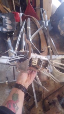

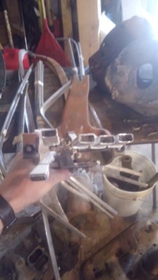

Does anybody have a picture of a 1963 plymouth b-body transmission push button selector housing ? Bought one , the person said it fits 63 and 64 .Thanks
1964 were different. The buttons were in a straight line. The 63 were at a angled.
I can post a pic of a 64 housing, if you would like to see one.
I got the 64 housing then . That's why it would not fit . Wonder if buttons will still work ? Thanks
The mechanism is the same. The buttons themselves are different. The buttons can be swapped.

1963 polara push button mechanism
