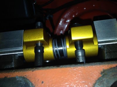

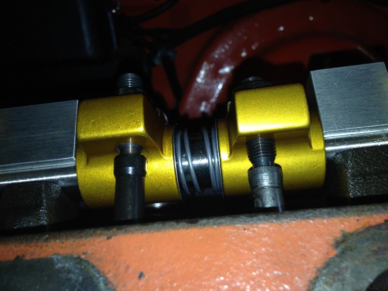

had 8 and 15/16" pushrods that seem too short, had 5 threads showing on the crane rocker adjuster.
ordered a set of 9.125 now have no threads showing, shoud I not use either and maybe order the 9.030 IMG_0148.jpg

when i check this way at the centerline of adjuster ball, the screw threads are even with rocker with no threads sticking out.
if I align straight edge with the actual contact point of cup and ball tip then the screw is up inside the rocker too far. the threads of rocker show.
It's hard to get the ball/cup interface lined up, so in lieu of that, I just leave as little thread showing as possible. The left setup above will work fine.
