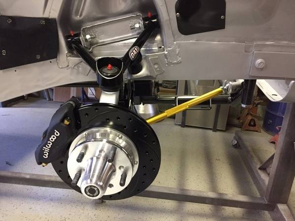

I used my old adjusters just wire wheeled them, sprayed them with some chassis black and some anti seize on the threads. Like 2 quick said the torsion bars can be a bit tricky but if you’re replacing them also just loosen the LCA and give It a few good whacks you might get lucky, I did. Or you can order the tool from Mancini or make your own just be careful not to knock the bars up. I did lowers uppers and struts it went pretty smooth.
