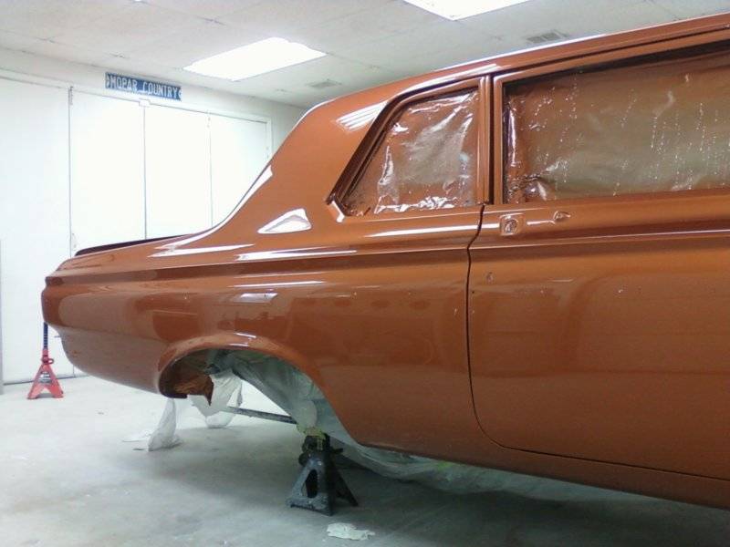

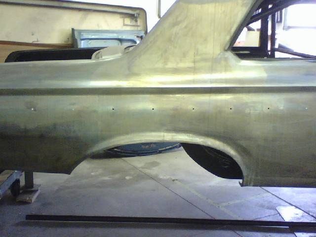

I think I might have done it differently. Leaving the original jam and cutting just behind the door opening. Three benefits,
1; you can adjust the gap to the door. 2; the striker is already in the correct location, 3; no messing with the pillar. Not sure where i'd cut it at top. But if the trunk opening fit height wise i'd cut it at the trunk edge. Why have a 5 foot weld in the middle of a panel. Not that you cant weld in the middle, just more chance of warpage. When I did my 64 there were no panels available. Also it needed the wheel well stretched. I am not a body guy. I did have some welding experience. This was 1st time panel fab with limited tools. Shrinker stretcher, vice , grinders, Vice grips, Clecos, Mig welder. This is just one portion that was worked.
Doug
