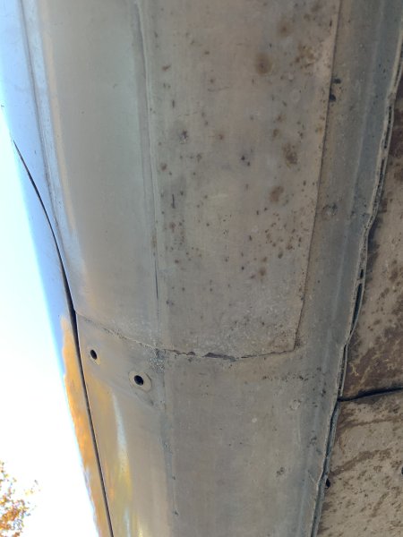

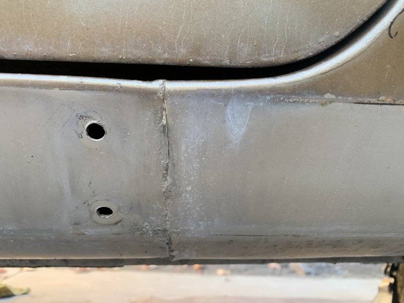

Hoping that someone can share a close up picture of where the quarter panel and the rocker panel are joined. My '63 overlaps the quarter. I have been finding a lot of poorly done sheetmetal work on this thing. Just need to see what's correct.

Hope this helps. 1965 satellite.
I'm quite familiar with 66-70 but I assume they have always been done the same way....... quarter wraps over the rocker and the seam is covered in lead; the underside of the overlap on the rocker seems to get passed over for the most part leaving the edge of the quarter exposed ....... the verticle overlap is somewhat recessed to accept the lead
problem is, often times moisture gets in behind the lead and rots everything out making it difficult to see how it was done
the rocker actually extends under the quarter and runs all the way to the outer wheel house
Thank you. Exactly the information that I needed.
