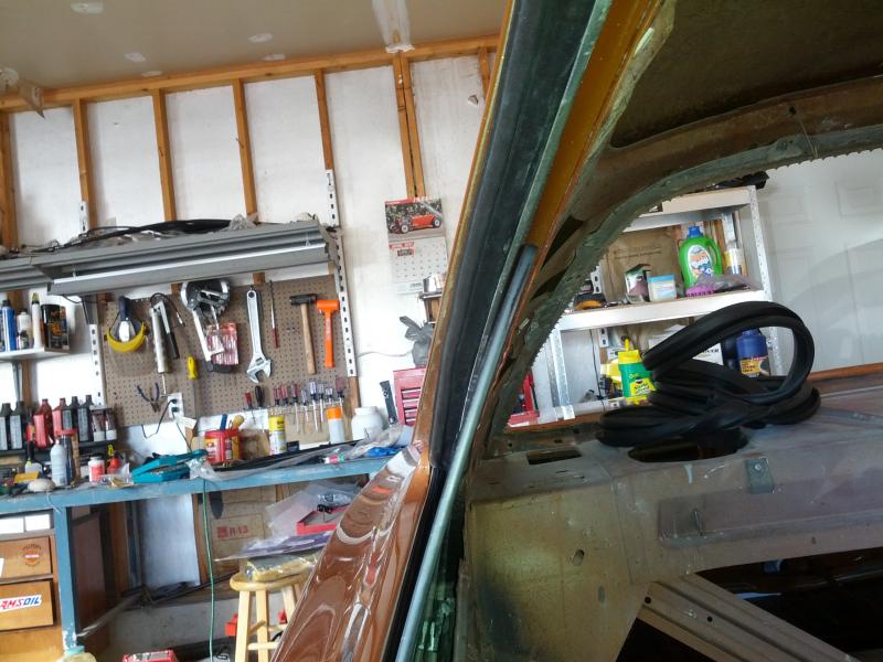

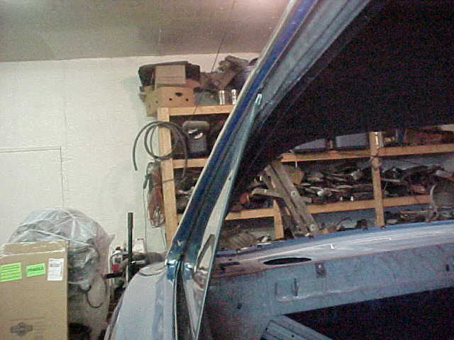

Guys,
I've tried adjusting everything and I just can't seem to get the window to swing enough outboard to get it to line up with the roof rail seal. As you can see from the picture I've got a ways to go to get it lined up. I've bottomed out my adjustments and the lower nut that is on the inside of the frame area that is connected to the long rail is pulled all the way inboard. Please help :(

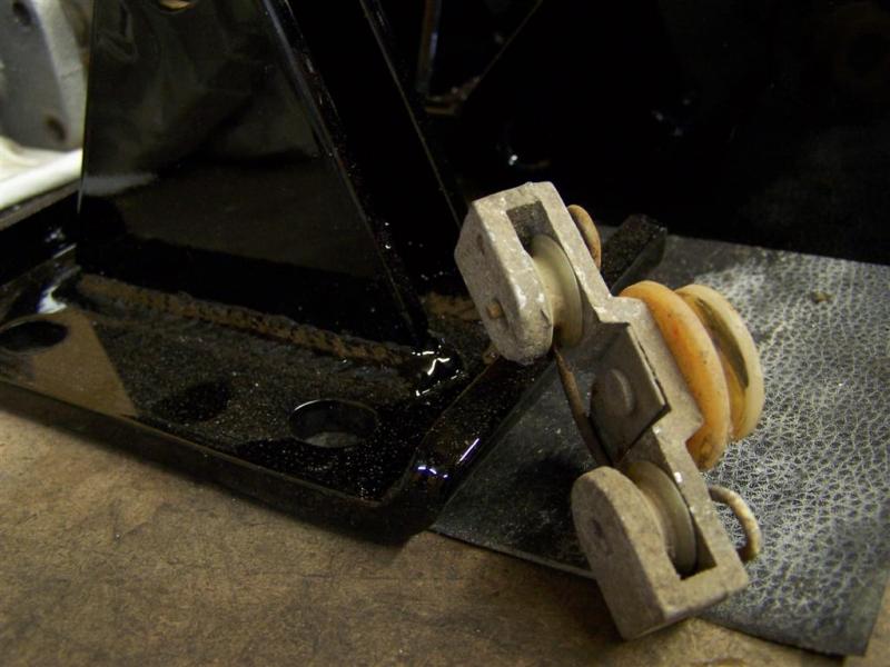

I just got done with this job on one of our '66 Chargers and the '66 Coronet convertible. Usually the bottom of the vertical track needs to go most of the way in and the top most of the way out. If you have the wrong/later style roller assembles you will have the issues you are seeing here.
My roller assemblies are not like the ones you have pictured, they are the ones that came on the car (69 RR). The potmetal piece on mine dont' have the indent in the middle like yours. I'm going to install the other side window and see if I have the same problems today. Boy is this frusturating, it seems like nothing as been easy in the reassembly department yet.
You sure that roof rail is in the right spot?Should be almost touching the pinch weld and it looks like i am seeing paint there,should be seeing paint on the outside of it.I just did mine saturday so its pretty fresh in my head yet.
Yeah it should be in the right spot, it won't go on any other way. Anybody got pics of thier roof rail?
Don't have any pics but have done a gazillion of these and I agree that the rail channel needs to be tight in the corner of the seam. The screws for the channel go into slots, not holes, so there is some adjustment there.
To adjust the top of the glass in and out there is an adjustor at the bottom of the track.
By the photos, it appears you don't have the 'wiskers' installed either. Are you taking into account that the inner one will push the window out some as it goes up? I held my fingers in place to fill the approximate gap while checking adjustments.

Sooooo check the adjustor at the bottom of the main track. Adjust bottom of track towards the inside of the car to pull the top of the glass outwards.
Guess you did that. Is the top of the track too far in?
I am not seeing a headliner either,much easier to pull tight without that roof rail stuff in there.
Looking at that pic again,you sure you dont have them flip flopped almost looks like the driver side on the pass side?

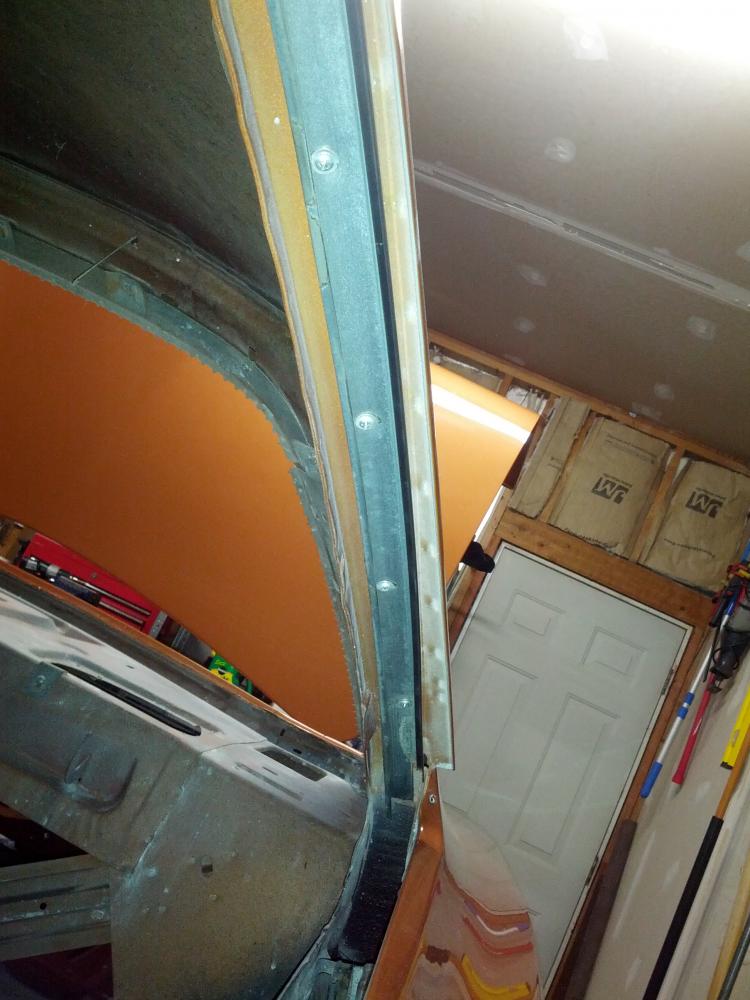

Ok, so I verified that the roof rail mouldings are on the right side and are spaced correctly. I verified this using my passenger side, that quarter window lines up just fine. So it's got to be something with the tracks, I checked all the rollers to make sure they were actually in thier guides. I guess why my driver's side picture looks like there is no paint showing outboard is because it's being blocked by the weatherstrip. Hopefully I can get this figured out soon, it's getting annoying. Here's a pic of the driver's side.

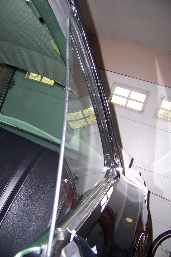

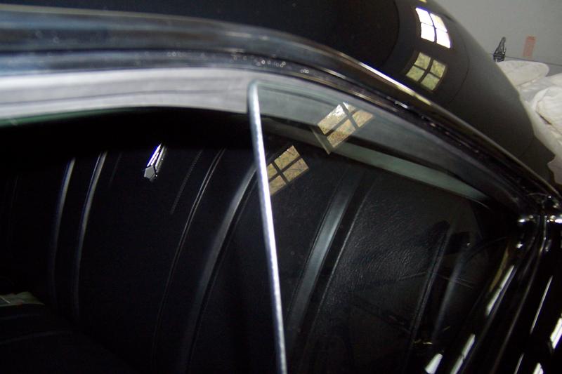

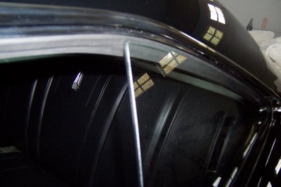

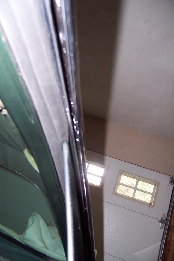

Your window is kicking in towards the inside of the car alot compared to wannadrag. Look where his window is at the top. Look where my glass ends up. This is a very time consuming thing. Hang in there. Its only the beginning.

Yup only the beginning is right,wait till you hang the door if you havent yet.Get ready for more glass adjusting.If the 1/4 window is off it holds the door glass out away from the seal.
The doors are hung but the windows aren't in them yet. I'm planning on installing the door window and vent window as an assembly. One thing I am noticing is that when looking at the roof rail seals from the bottom there is a thick side and skinnier side. On my car the thick side is inboard where i looks like wannadrag and Dave's is outboard. Do I have my roof rail seals on the wrong side? I know this isn't going to help my window alignment but at least I can fix that and feel I accomplished something :)
