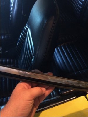

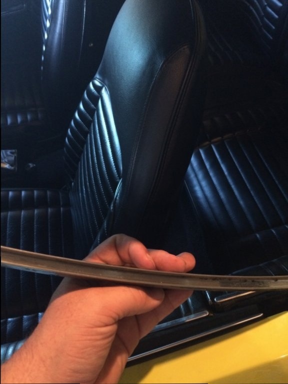

Putting my 72 back together and I'm just wondering if there is a rubber piece to fit in here, or do I spray some weather stripping caulking in there and place it on the quarter window. I've attached two pictures. Thanks.

a rubber channel fits in the groove there
that press fits onto the window..

Any automotive glass shop will have that stuff. I think there are a couple different thickness's but they should have what you need.

The stuff you are looking for is a rubber tape. It is called "glass setting tape" It comes in 1/16" or 1/32" X 1.5W I think we used the 1/16" stuff in my 68 Charger.
Steele Rubber products has it by the foot. You wrap it around the glass and tap the channel on to it. Then trim off the excess. Try this site.

Bob Drake Reproductions sells roll of variable thickness at a very reasonable price. Just used the 1/16 inch on my GTX.
