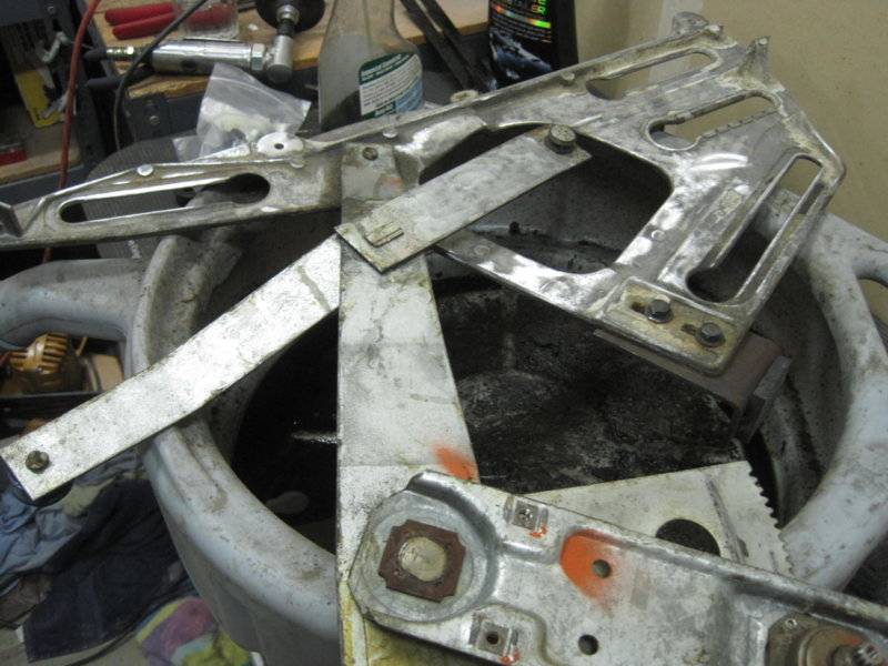

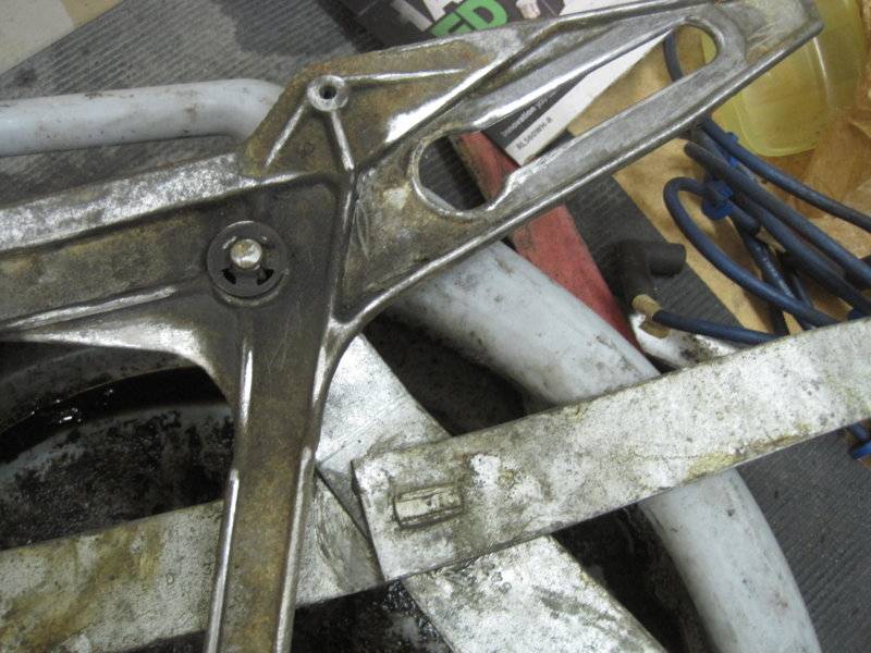

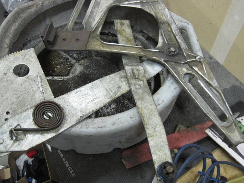

I refurbished the quarter window mechanism on the Coronet, replaced the rollers. The 69 quarter window rests in a channel, I don't remember any bolts through the glass, but your 67 could be different. Here's pics of one assembly. I think i used general use grease lightly applied; also WD-40. The OEM stuff had the consistency of dried peanut butter; the quarters will slide much easier once you're done.

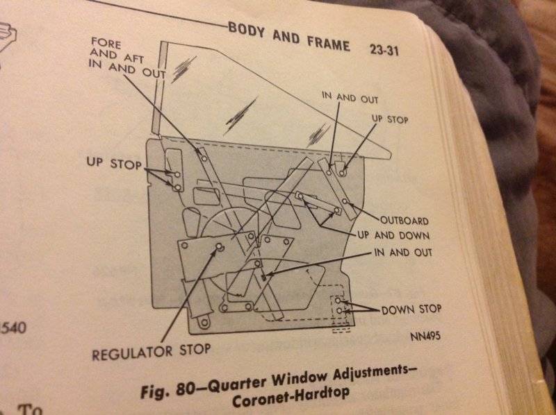

The best exploded view is going to be in a factory service manual. The only 2 holes in the glass are to attach it to the frame. The rollers your talking about are in a rear upper channel and attach to a slot in the frame that holds the window.

Thanks guys, I did not take the window/regulator out, but the track, I beleive, is the rearward one that centers the window in the reveal. I did not see/feel any place that a roller could attach except a quarter sized hole in the glass itself.?.?.?

Here's a picture from the FSM. I didn't notice any holes that large on my 67 in the glass.
