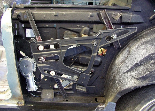

I removed the left side quarter window regulator and I can't remember how it goes back in. Should I take it apart and install each piece separate or try to wiggle the whole thing back in. I'm trying to look at the other side to help figure it out but not a lot of luck. Thanks in advance:( :thankyou:.
Here ya go.
That is Awesome! Thanks. Looks like I'll have to install it as one unit.
You don't actually install as one unit, this pic can be deceiving because it was taken with the quarters removed. Notice the two longer roller slides pointing to the 11 o'clock position, those are installed first, then the actual regulator, then the big piece that all the rollers run on. It's a pain but not near as a pain as you are about to face....ALIGNING THE QUARTER WINDOW SUCKS!!!
