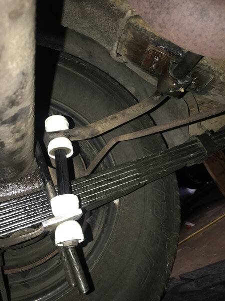

One of the brackets where the end links bolt thru is broken and I was wondering if anyone has come up with a solution for something that worked other than how addco designed it which is not exactly the best.

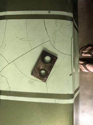

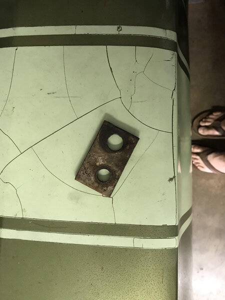

Attached is a picture of the lower link bracket I have that isn't broke. it's essentially just a piece of 3/8" thick strap with two holes, one to go thru the Leaf Spring U-Bolt and another for that the sway bar end link passes thru.
Any Ideas on a better solution other than making another one of these brackets?
FWIW, I made sure and took the picture with my flip flops in the picture for Freiburger if he ever see's it :)

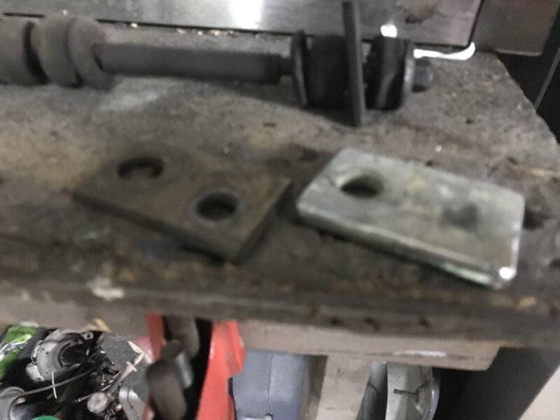

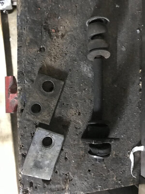

So I got tired of having this on my repair list and decided to get after it. I made new tabs out of thicker metal and all I need to do now is buy new end links, drill the hole in the tab for where the end links pass thru it, and bolt them on. Then when it's all on, I need to get under the car with a cut-off wheel and cut the U-Bolts down so they're not looking for something to snag.

Got the Moog K700534 end links delivered today so I bolted up my hokey tabs. I'm not happy with the angle of them so I'm thinking about buying some new U Bolt spring plates and welding on a gusseted tab that moves the sway bar end link forward and perhaps angles it a tad to not put so much deflection into the bushings. I must say that the Moog K700534 end links feel like pretty good quality and they're made in the US of A which is a huge plus...can't beat them for the price of $6 each on Amazon either. I ordered 4.5" ones and perhaps should have gotten 5" or 5.5" ones.
