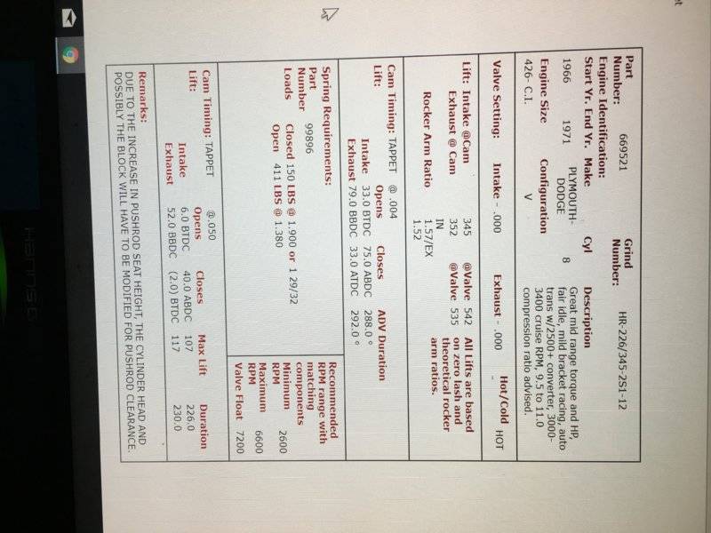

Thanks I am Now overloaded with info, but I haven't ordered a cam yet.
Wow! all that cam stuff went right over my head. I got a 472 hemi 10.5 compression with this cam. Will it have enough vacuum for power brakes?
1971 Superbee - Factory Power Disc Brakes
I ran the Mopar 284/484 cam within my 383 Magnum for over twenty years - About 8" of vacuum at idle
Now same #s block , 432 Stroker - Running the Comp XE275 HL - About 12"-14" of vacuum at idle / 700 - 800 RPM Idle
10.58 to 1 Compression
Edelbrock E Street 75cc
Comp XE275 HL - Honestly feels like it has twice the Torque off idle through 4500 Rpms / Awesome shake the car idle within the 383
But so did the Mopar 284/484 at idle , but the cam itself ended there until about 3500/4000 RPMs
No issues with Power Brakes
Damn just saw this thread was a few years old
