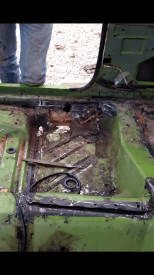

replacing the floor pans in a 71 RR, front and rear. ive been looking at every different brand of pans out there, does anyone know if the rear floor pans from amd, or anyone else for that matter include the rear seat belt mounting points? the pictures look like they are patch panels, but I need the entire thing because those are the sections that are gone.

I need the rear pan (large) you described. my under seat pan is rock solid as is the trunk pan
Here's what I'm dealing with, someone decided to drill that mess into the main channel in order to somehow attach a seat belt. The actual seat belt attaching point is gone...rotted away on both sides
duh, nevermind. they've got what I need. I was looking at the picture wrong.....
i see the pic
that is the small footwell pan
there are 2 sides to it
they make that one.
you have a real rotter to need that last pan..
time to start drilling it out..
