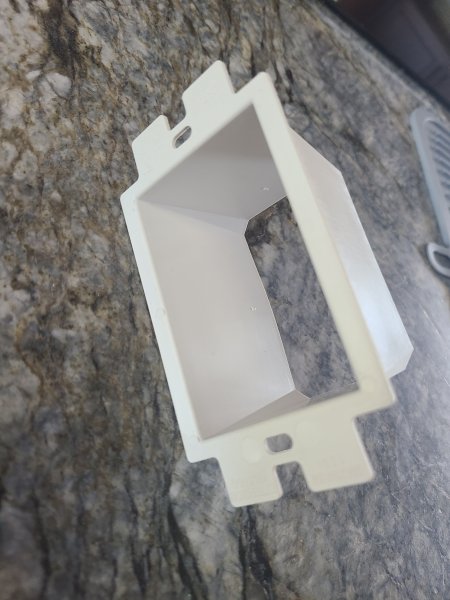

I used mud rings when I prewired houses for built-in home theater and multi-room stereo systems. They can be used without a J-box for low voltage only. What @CarolinaCharger is talking about looks like this:
These work great and are Code approved and UL listed and are cheap. Flash or fire rings. Are made just for what the OP is doing.
I've always heard them called mud rings... And probably 75% of tile installs don't have them, just spacers like Dan was referring to.... View attachment 1475077
Those are for 4" sq. boxes. Mostly used in commercial and industrial. Mud rings or tile rings depending on which style.
