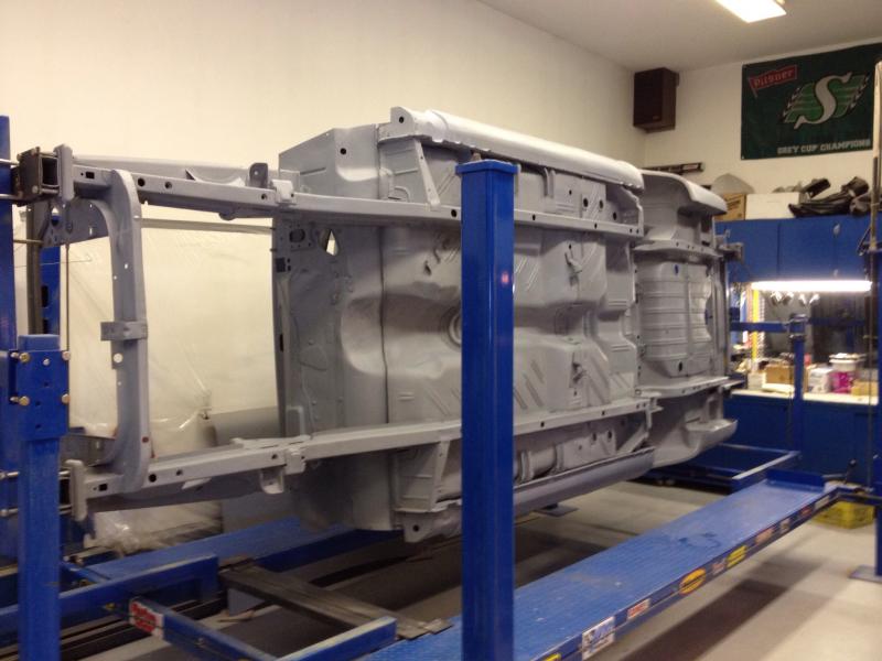

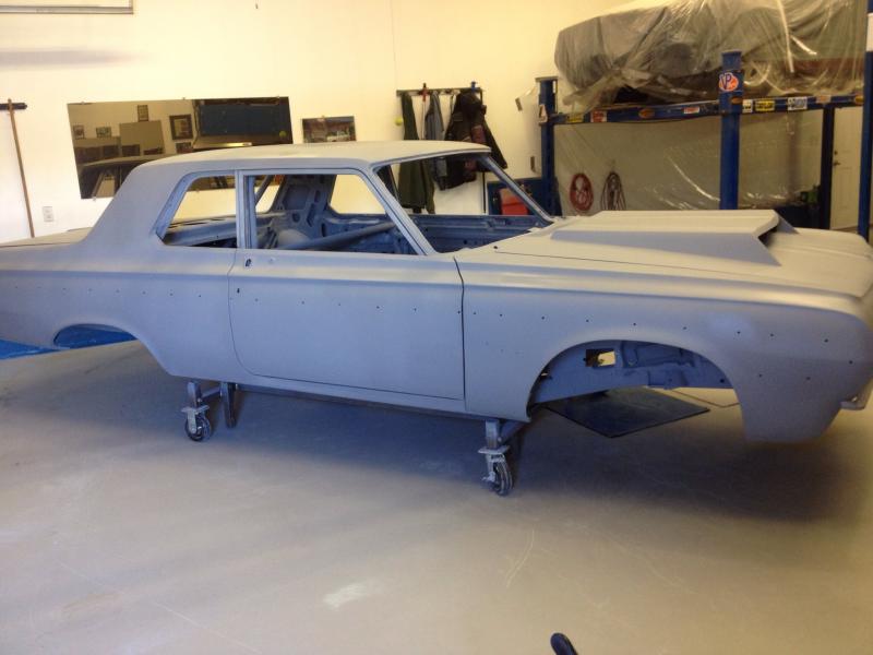

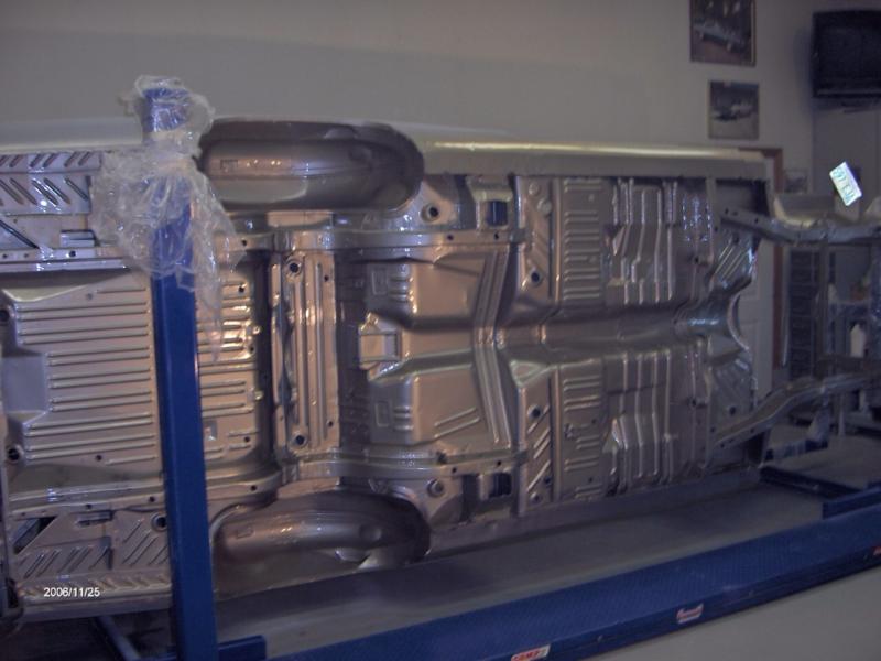

I'm at the point of your question right now, and will be painting in a couple of days. I have the car back on the rotisserie and all sheet metal is back off. I'll be doing basically everything except the roof, quarters and windshield cowl.

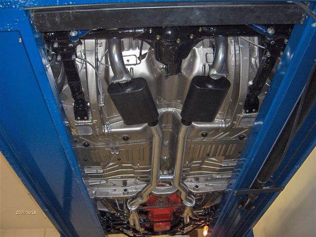

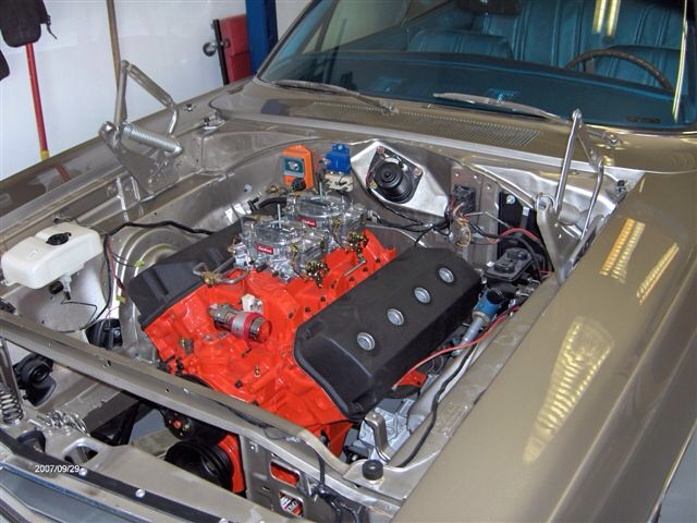

Once the chassis is back on the wagon I'll install the trimmed out fenders and doors. Lots of masking and then the next steps. That's the way I do them. image.jpgimage.jpgimage.jpg

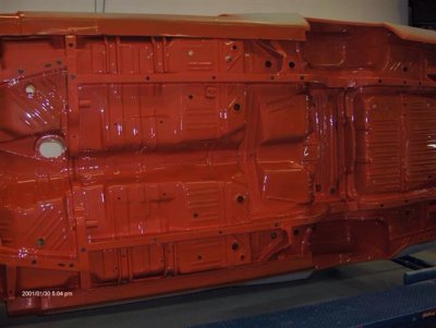

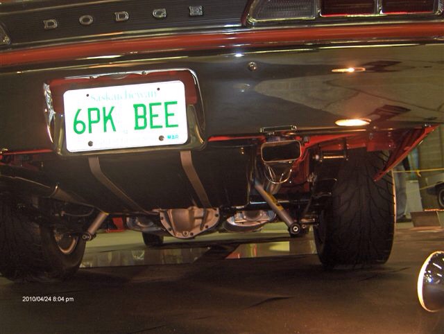

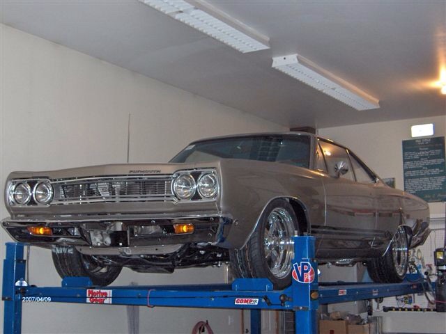

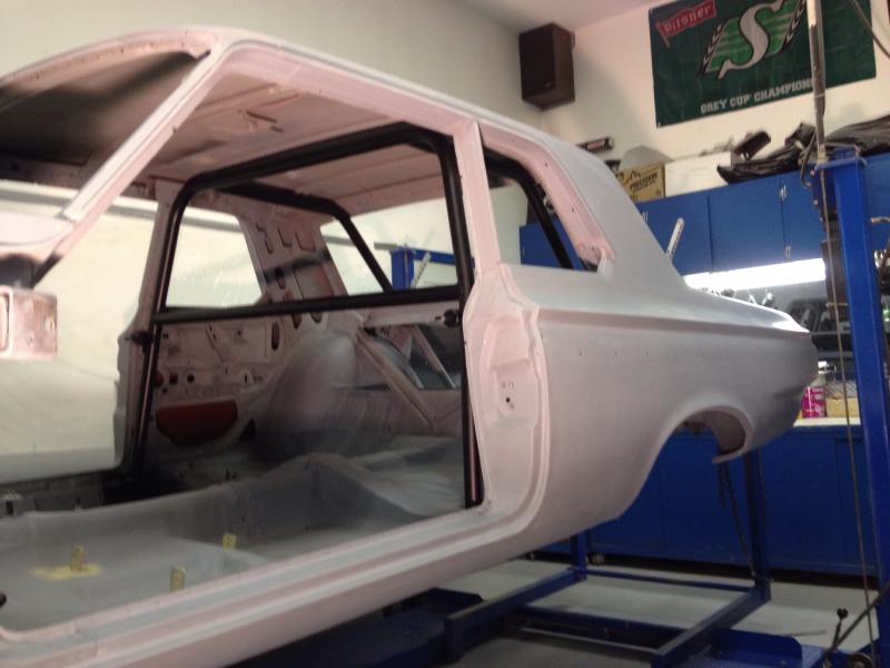

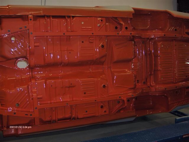

image.jpgimage.jpgimage.jpg A couple of other pics using this method.
