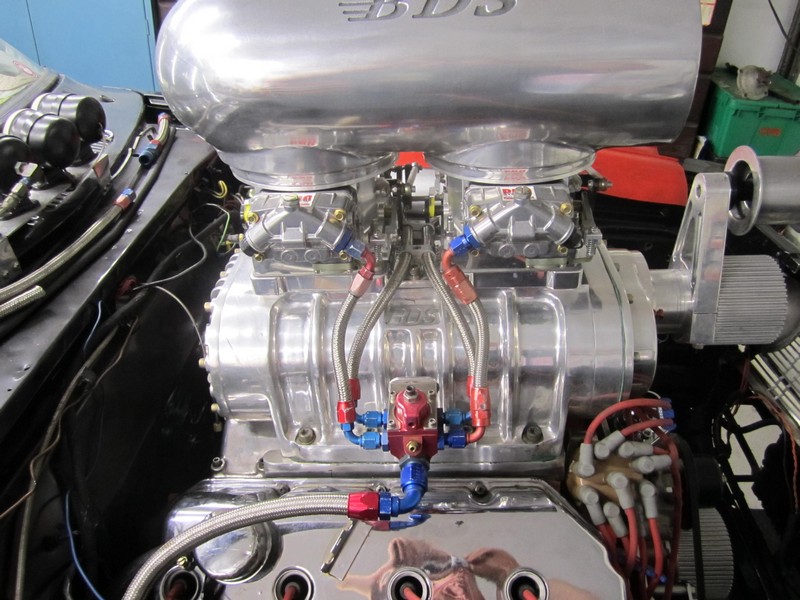

The hemi head is more resistant to detonation than any wedge design.12:1 might be pushing the limit depending on the cam & ignition timing:eusa_think:
