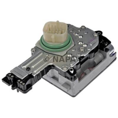

looks like napa offers 3 separate solenoids for 2001 ...... on the napa site there are like 6 trannys to choose from for 01 durango... how do I i.d. a tranny? I think I picked the right one
which one of these would be a "shift solenoid"?, if any? since that was one of the original codes
https://www.napaonline.com/en/p/NDP60904201?searchCategory=c8.s5&searchIndex=Universal
https://www.napaonline.com/en/p/ECHTCS602?searchCategory=c8.s5&searchIndex=Universal
https://www.napaonline.com/en/p/ECHTCS558?searchCategory=c8.s5&searchIndex=Universal

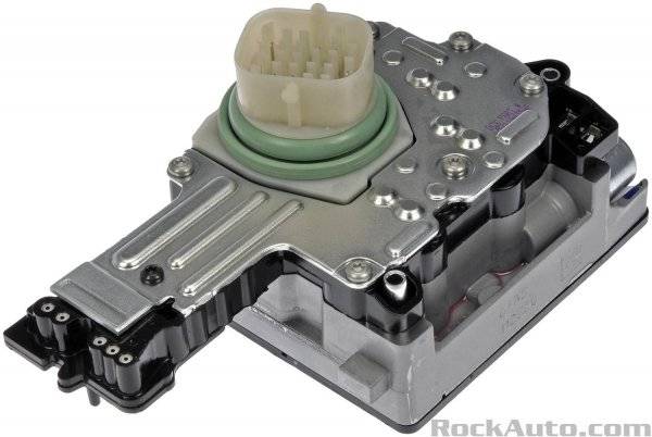

its the top one lol.... the expensive one....... rock auto calls it a shift solenoid
https://www.rockauto.com/en/moreinfo.php?pk=8361344&cc=1371901&jsn=8

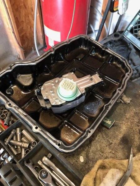

Does your trans pan look like mine?
This is the shift solenoid from your first link:
Looks the same as mine.

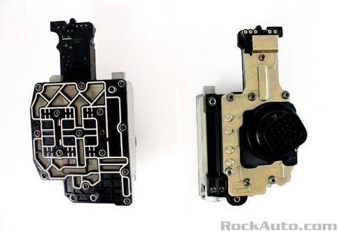

wait.... now confusion... rock auto also offers a kickdown solenoid

The only electrical part I can remember from inside my trans is the one that I posted. I'm not familiar with the other ones.
so rock auto and napa both offer a "kick down" but only rock auto has the "shift solenoid" but it's out of stock...... wtf

so it appears to me that the kickdown solenoid and the shift solenoid are the same thing....this guy calls it kickdown
I went with what the Code Reader and Dealer called it.
It does far more than just control the downshift/Kickdown functions.
Having a 2 post lift made it a fairly easy job aside from having a little ATF+4 in my face.
evidently the white plug unit they are calling "kickdown" solenoid replaces the black plug unit listed on rock auto as a "shift" solenoid in 99-03 models...... and must also replace the "detent plate" mentioned at 9:15 here.... i'll be an expert next week
that explains why rock auto lists the "shift solenoid" (pictured differently and with a black plug) as out of stock
