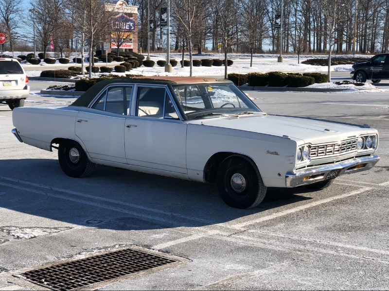

I’ve been driving the 383 in this since 2004. It’s been my daily everyday since 2014. All I’ve ever put in the tank is 93 unleaded. The engine’s never been apart, and doesn’t burn much of the Mobile 10w-40 I put in it.

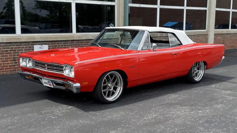

Nice convertible.
I’ve used Mobile One every 10k in all my cars forever. I had a 97 Neon that went over 300k. I only changed the timing belt once at 200k and the old one looked new.
