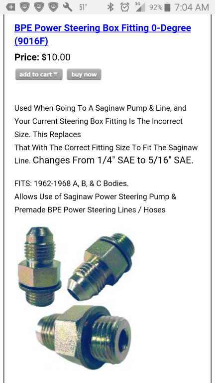

I put a Saginaw on my 69 using factory bracket and bought the fitting to make the original hose fit. I'll see if I can find the company I bought it from but I know they specialized in brackets and pulleys.

Bouchillon performance is where I got mine. This will make a saginaw line from a later mopar fit your box.

Thanks 747 , that fitting will help.
