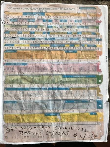

A friend of ours has a '74 Charger and he is trying to find out if it was one or the last one built.
The VIN is: WP29U4A245212.
I also have a copy of the build sheet as well if that will help.
Jeff
Far from it.
74 Lynch Road ran at least until 722 SPD with a VIN of 284*** or about two months and 40,000 cars after this one.
