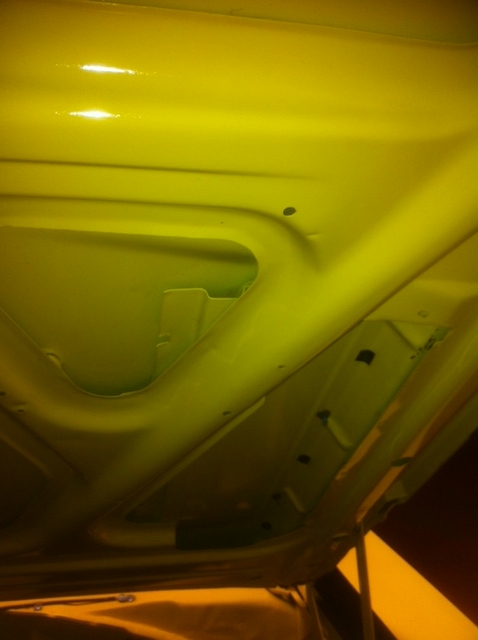

Does anyone have a pic of the underside of the hood so I can see where the airgrabber attaches too?
Also, any idea if I need to remove these silver plates that look to be under the mesh vents? I am trying to add in an Air Grabber setup...
How does the air flow from the vents into the fiberglass channels?

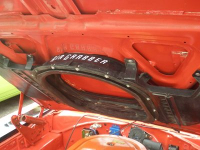

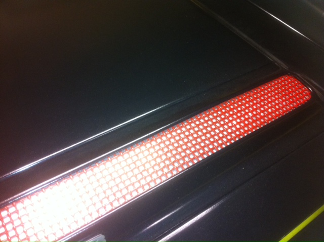

Pic #1 is my air vent on hood. This was not an original air grabber. See the metal plate under the mesh
Pci 32 is the under side of the hood... trying to understand how the airflow works and where the fiberglass sections connect to...

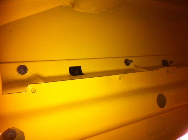

Take off the hood inserts....You have about 7-8 studs and pal nuts (or some sort of fastener, who knows after 43 years) underneath holding each side in. Once the insert is off, on the underside of it you'll see little L-shaped brackets with phillips screws holding that plate in place...

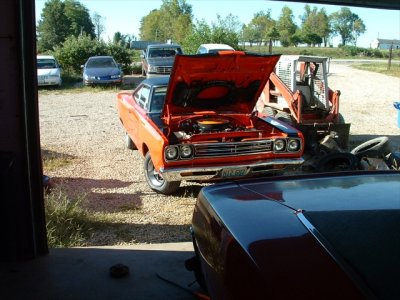

not great or up close but here goes
Your hood is not a N96 Air Grabber hood, it does not have the sheet metal cut outs under your mesh inserts to allow fresh air to pass thru the hood to your duct work.
The hood looks right to me- just the screens have something blocking the air. I may be wrong, but I thought all 69 RoadRunner/GTX hoods were the same, just the airgrabber setup had screens.
The airgrabber ducts are attatched to the underside of the hood with large O.D. aluminum rivets, and palnuts and bolts. I don't have any pics to share, but I see the hardware kits on ebay all the time. The 69 factory service manual has a pic of how it all goes together.
Propwash mentions that the plate cane be removed. I guess I will find out.... Not sure why the plate is there.. could be because only the vents were installed and the underhood duct work wasnt done yet..... Kinda weird...

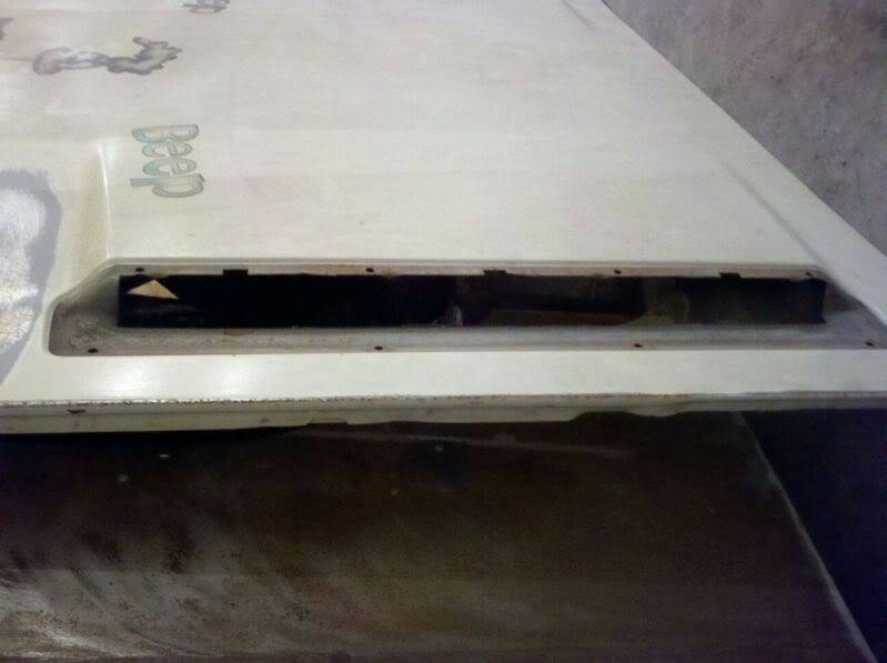

ok. I removed the hood vents and removed the metal plate per the advice above.
I am confused still. The recessed sections of the hood that the air vents sit on dont have a opening for the air to flow through..... Any ideas? I just had an air grabber fiberglass unit restored to mount under my hood. I am not certain how it will suck air into the cleaner.
Any ideas?

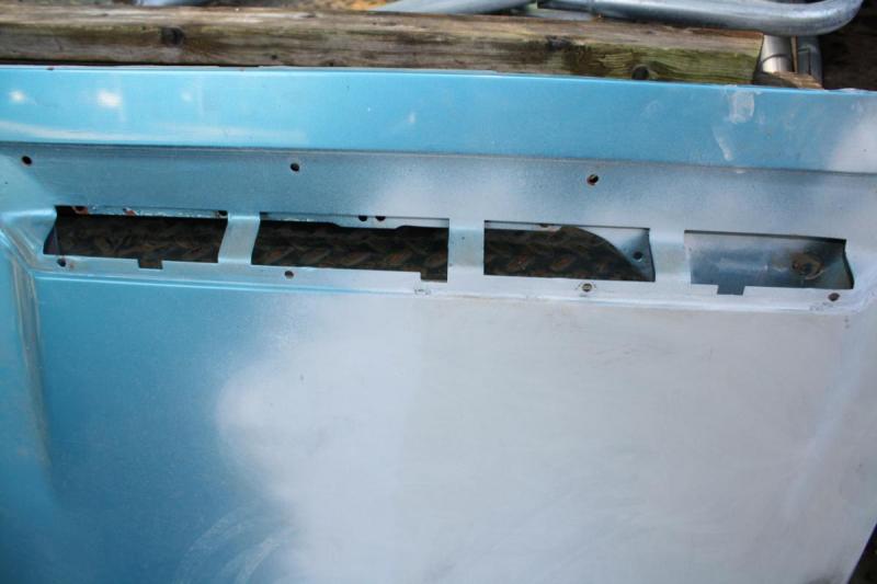

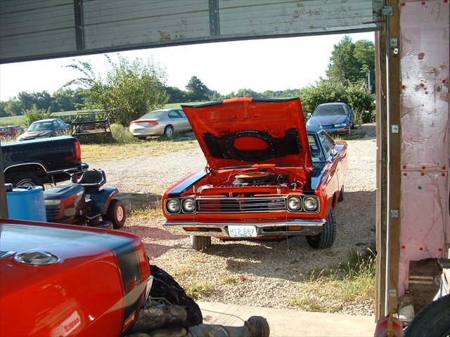

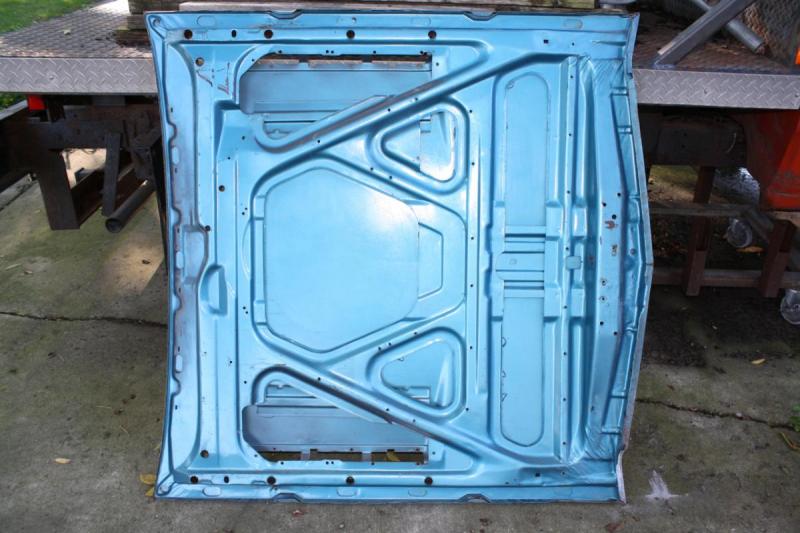

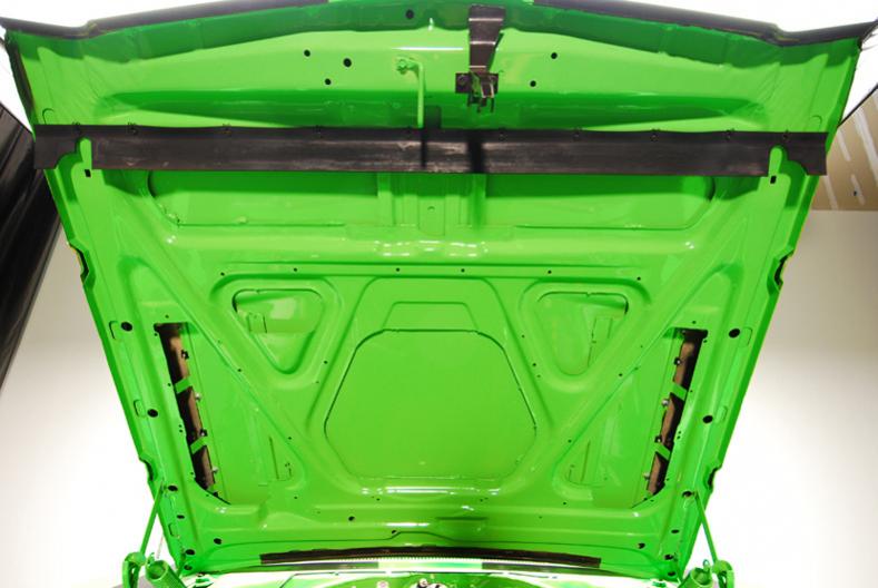

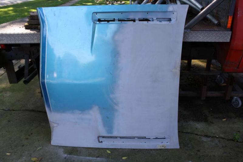

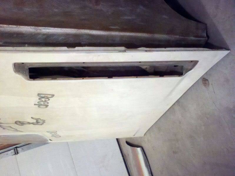

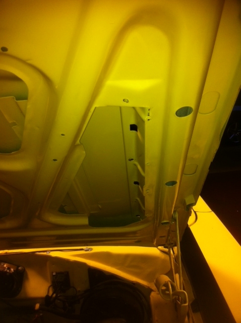

Here are some pics I have found that show cut outs in the hood. Not sure if they are correct...
Thoughts?
ok.. got this pic from the RK Motors sales web site. This is leading me to believe that these cutouts are what should be in a Air Grabber Hood from factory. Looks like I may be able to mimic them by cutting the hood.

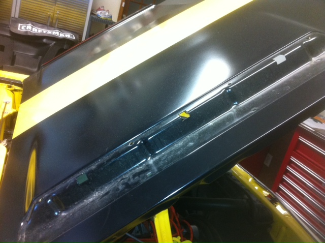

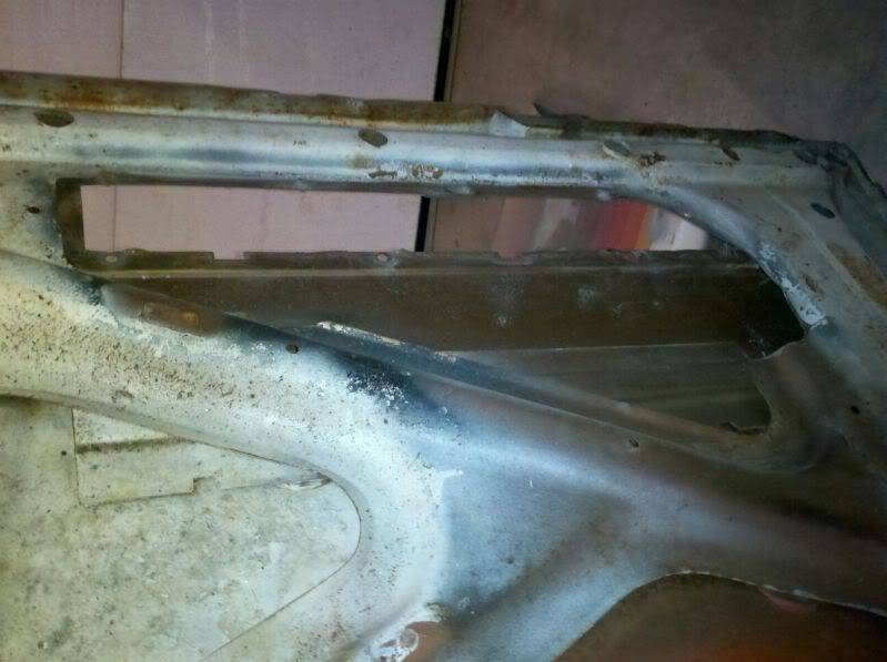

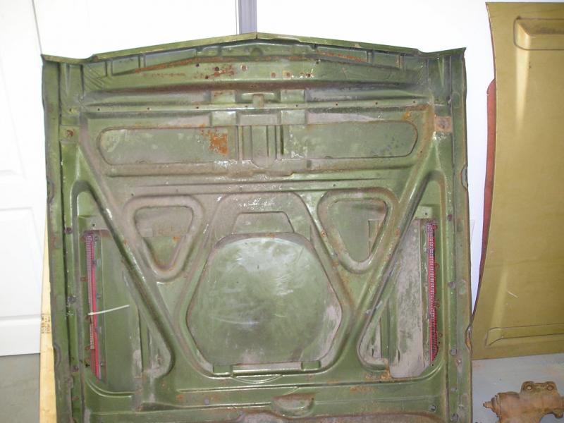

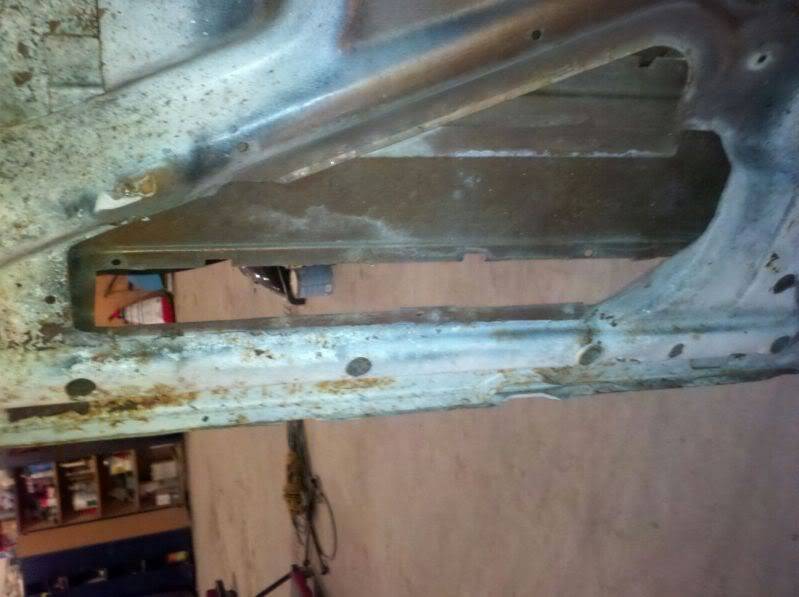

I have my 69 RR N96 hood apart right now.
I'll go snap a couple phone pis for you.
Hold on.
well, thanks, lol!
here's my crappy pictures of my crusty hood.
looks like mine doesn't have those ribs, but mine is unaltered. I drilled the rivets to take out all my N96 pieces so I could strip and paint the hood shell and freshen up the N96 with new hardware and gaskets/boot.

The hood that you have with your car appears to be one from `68, pre availability of the N96 option. I think all `69s had the cutouts. The first pic in post #10 is a good one for how they looked fro the factory. As far as the inserts, that is where the difference in the N96 and non-N96 was, not the hoods themselves.

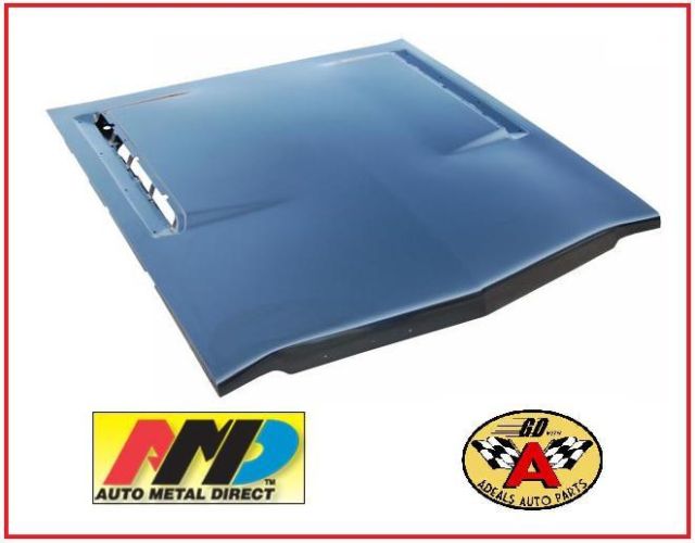

here is a picture of the hood AMD lists for the 1968-1969 roadrunner. Seems the the same hood is sold for both the 68 and 69 cars. I will call them to ask for more detail....
called the AMD guys and they mentioned that they believe the 68 hoods did not have the cut outs and that all the 69 hoods had the cut outs. They said other than that the hoods are completely interchangable.
I took a close look at my hood and compared it to the green and blue hoods above with the air grabber cutouts. My hood has the exact same small holes as those 2 hoods. It looks like those small pin size holes are used to mount the rivets for the air grabber unit. So this would lead me to believe that after we cut out the openings in the hood using images of the hood cut outs above as a template, we can simply rivet on the fiberglass air grabber unit to the bottom of the hood.
Thoughts?
Yours looks like it should accept the ductwork without issue. If yours happened to be an early `68 hood the underside might be different and not accomidate the ductwork. I found that on 2 `68 Coronet hoods I had 1 early and 1 late, that they had different understructure and through a little research figured out that mid year or later they changed tooling in preparation for the N96 option in `69. I don't know any of this for sure, I was not there but that's the best way I can make sense out of it. Hope it works out for you.
