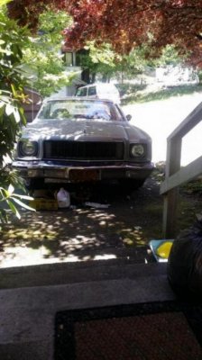

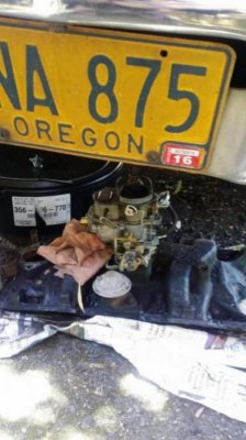

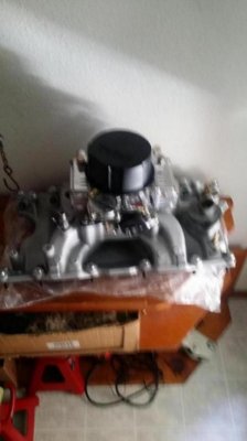

Here we go! 4th pic is of the old, dirty manifold (bruised my ribcage pulling that sucker off) 1st is the new setup, sorry for the shakey phone pics. Thank you again!
