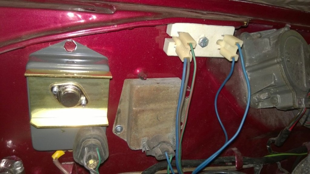

This is the ballast on the car now. I know each side has a different resistance rating, but I'd like to make sure that he's got the connectors going to the right posts. Looks pretty easy to mistakenly install it upside-down?

Got electronic ignition, ditch the resister you don't need it.
check it with out it.
With Mopar electronic ignition, they specifically say you gotta keep the ballast.
What is the voltage rating of your new msd coil? Likely has a 12 volt primary side. It is my understanding that ballast resistors are used to drop the voltage to the coil because the stock coil primary side is wound for less than 12 volts.
Seems like your car is running, What is the problem, weak spark?

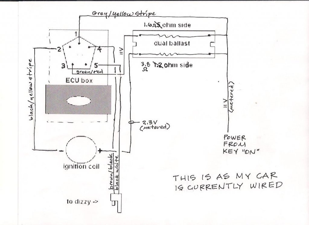

Ok, I think I have some answers here. This is as my car is currently wired:
Now, see how the ballast is basically upside down? The LOWER resistance side should be going to the + of the coil, but instead the HIGHER side is!
Also note the resistance values I got. They're both not exactly right, either. Ballast is probably close to dead.
Here's the kicker, though - see the "green/red" wire coming from the top side of the ballast to the #3 pin of the ECU?
The #3 pin of the ECU is the "missing" pin in a typical 4-pin ECU.
In other words, that voltage is currently going NOWHERE.
Typical ECU:
(Note #3 pin "missing")
Now see if y'all come to the same conclusions I am here:
1. The top side wiring of the ballast is basically worthless as it stands now. It goes nowhere and obviously isn't needed in order for the car to run - because it DOES run, just not as well as it should.
2. "John" must have used a wiring diagram for an old double ballast installation, but he got the ballast turned upside down. Not only that, but it apparently didn't occur to him that he'd need a 5-pin ECU in order for the double ballast to work as intended.
3. The actual wiring job is pretty much correct, as far as it went.
It appears I can simply buy a new SINGLE ballast of 1.2ohm value and plug the bottom part of both sides of my current ballast plug-ins to it.
That current 2.3V going to the coil + isn't making a whole lot of spark, which WOULD in fact explain the issues I've been having with fouled plugs and loss of power on top end :-)
It should be a ton better with that voltage to coil + going through a 1.2ohm resistor rather than the current 3.8ohm, eh?
Make sense?
My head hurts now. :)

Yep, I reckon things are about to get a bit better under the hood.
I thought about just flipping the ballast over, then figured heck, go on and get the right ballast as Ma Mopar intended.
I sure have a nice collection of new spare parts because of chasing this issue...
Update:
PROGRESS! I'm so happy I could just....well, you know.
Bought a 1.2ohm single resistor from NAPA today (Echlin brand, made in USA:usflag:) and stuck it on there.
Turned the key to ON and got 4.5V to the coil +.
That's about double what I got before.
"That's encouraging" I thought...
Gave it a couple pumps of the throttle and cranked her up (I don't have any choke set up on the Edelbrock).
I could tell the difference instantly. None of the usual stumbling around until it got some heat in it - it basically held an idle after me keeping it going for like 15 seconds.
That's even more encouraging....
Grabbed the meter and first checked voltage at the battery (remember, I've put a new voltage regulator on it as well but hadn't checked it out yet). Battery showed charging @ 14.4V.
That's encouraging, too...
Put the meter back on the coil + and got 7.5V @ idle (I was getting like 4.3 before).
The engine was noticeably happier sounding, like it wasn't laboring as much.
Well, there's only one more test to do, I thought.
Got behind the wheel and let it build a little heat in the engine, then gave it steady throttle input, making it climb up through the RPM's slowly and smoothly.
It seemed a LOT smoother all the way up. :thumbsup:
It got to the "magic" 4k RPM threshold (where everything historically started falling apart in the past) and it was still smooth, so I went further - all the way up to 5500RPM!
Let it get up to 180F and then started aggressively gunning it, revving up past 5k two or three times in quick succession.
No stumbles, no falling on its' face, no popping or misfires.
It acted like a damn Mopar!
Now sure, I still have a little tuning of timing and carb and such to do I'm sure, but it's in the damn ballpark for the first time literally since I bought the car; we're talking more than a few YEARS here.
The engine actually sounds healthy, thank God.
I know I sound all dramatic here, but those of you who've read all my threads here in the past about all the things I've tried to chase this problem down....
the word "relief" doesn't begin to describe it.
Only question left is - do I go with a lower value ballast to increase voltage at the coil a little more, or is that even beneficial at this point?
THANKS EVERYONE for helping!
