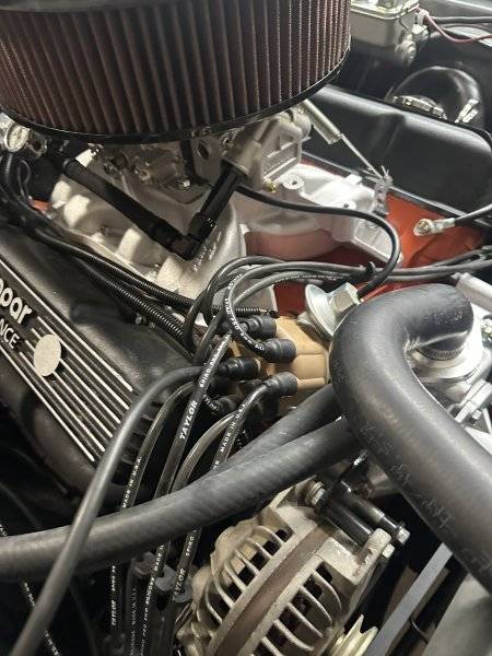

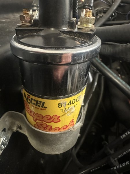

Hi everyone, I’m new here. Just bought a 69 super bee with 383 mild cam , stock 906 heads. The previous owner said he put a new electronic distributor and ignition box on. I notice when the car is running for several minutes the coil gets really hot to the point you can’t touch it. I tested the coil and it tested ok. I made sure the ignition module was grounded. With the engine running the positive side of the coil is 11.8 volts. That seems high? Maybe need different ballast resistor? It looks new.
The coil is Accell super stock. Here’s some pics. What do you think?

I would look for a ballast resistor with some more impedence (resistance).
They are inexpensive so when you find one that works better get 2 and have a spare.
The number on the coil looks to be 81400 or 8140C. Punch 'Accel XXXXX' into Google & you will find the info on bal res & if needed..
