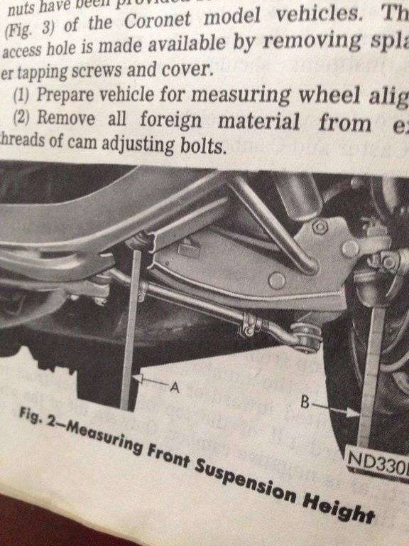

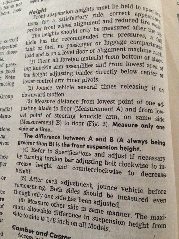

Not quite, but close.
1. Set ride height with torsion bars.
2. Adjust caster AND camber using the upper control arm bolts/cams.
3. Adjust toe at the tie rod ends.
Here's the height procedure.

Okay. This helps also, thanks.
One question though. Do you mess with each bolt until you get caster/camber right or do you mess with the rear bolt first, front bolt 2nd? I was going to use a square against the tire to get those adjustments right and use a tape measure for toe.
