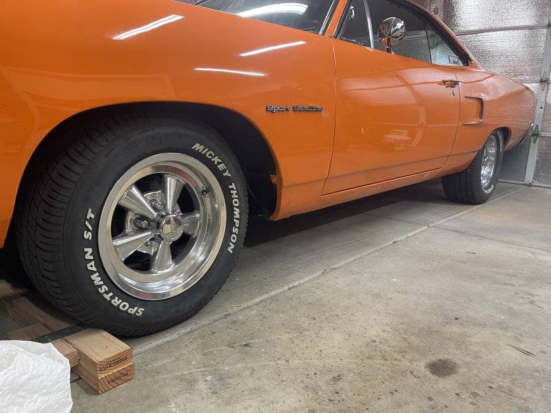

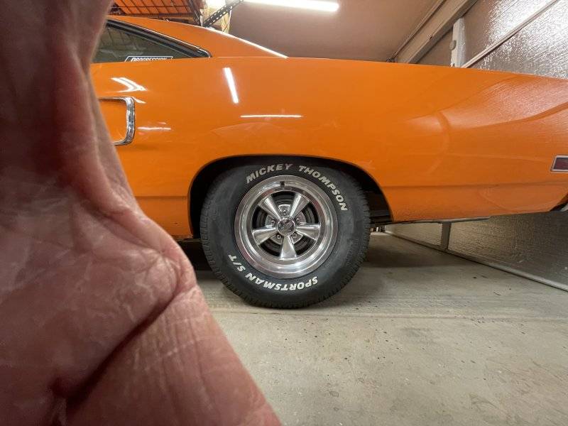

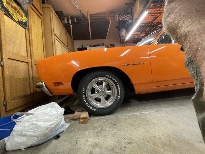

Front wheels are squealing over 20mph driving straight. Car does not pull but IS A BIT TWITCHY. I am not to familiar with bbodies drivability because all I have been doing for the last year is work on it lol.
Bbody with a small block. Original suspension but using gas shocks not hydraulic. Also front tire size is 235x60x15
Rears 275x60x15
Q1. I assume it needs an alignment but my question is does a squealing tire indicate more a toe in is off as compared to camber or caster?
Q2. I assume if it’s over twitchy that an alignment would help. If not what should I be looking at?
