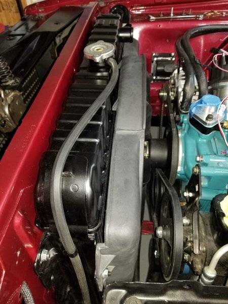

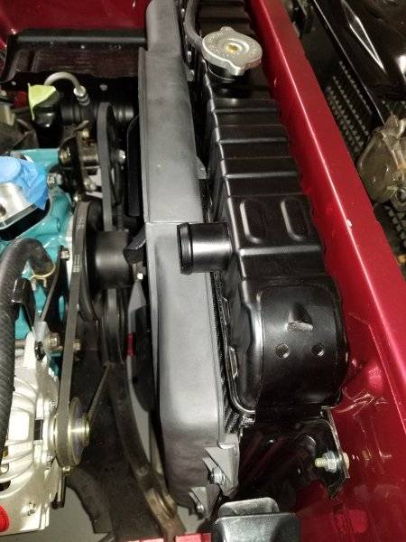

There is about 1/8 to 3/16 gap between rad and fan shroud at the top where the two meet. Rad is Glenray and shroud is OEM Is this an issue? Should the top of shroud but right up against rad?. I could easily use some weather strip to seal the top. Sides are fine. Thanks

Yes, you should glue a piece of black foam in the gap. The most important time to have all
of the air flow going through the radiator is when you're idling. When you're doing 45 or
so, there is enough air flow to keep things cool but when you're stuck in traffic you need
all the help you can get.
No don't worry about it. There will be way more than enough air being drawn through the radiator to do its job. No sense cobbling something up that will look non stock
Mine is that way, with ac and I thought it might be an issue, but it hasn't been so far.
That's the way a lot of them came from the factory. Up to you if you want to "improve" things there...
The ones on my Dakota and the diesel are better but that's not bad and like mentioned above, if there's no issues with temp, it'll be fine. Heck, I'm not even running a shroud on my other Dakota and it's doing fine even in this 102 crap....
Thanks. Car not running yet so unknown on overheat issues. I doubt it will overheat either way. Gets real hot out here in the summer though. If filling that gap increases cooling efficiency then I'm good with it.
Frank
The gap is normal but if you seal the gap all the way around the shroud, you'll eliminate pulling some of that really hot engine compartment air instead of 100% coming from much cooler air that's in front of the radiator. So you'll get more air through the radiator and you'll get more cooler air. It will make a measurable difference both in temps and cfm when sitting in traffic. Of course there is an aesthetic aspect that only you can decide whether it's bothersome.
OP I have the same gap on my repop shroud. I wonder why they did it like that originally? I tried squeezing in some foam (but didn’t glue) and it dislodged in not many miles. I would just leave as is.
