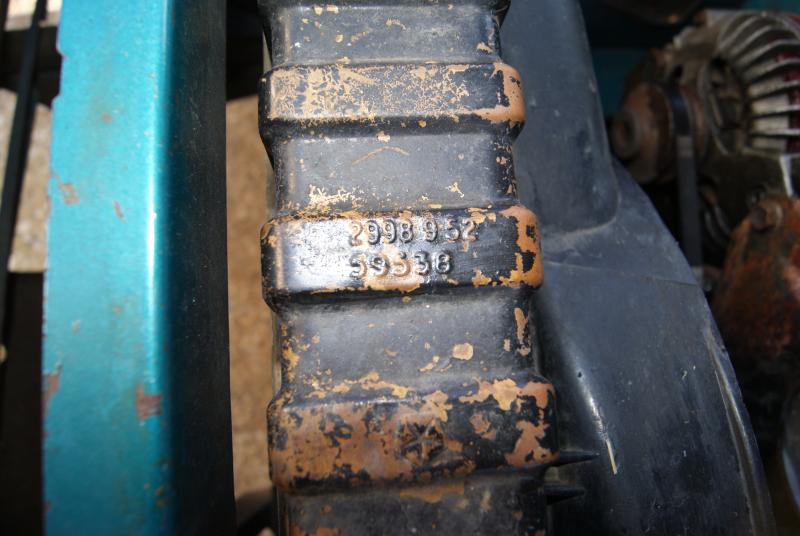

I have a 68 Coronet with a small block. Looking at the number on my 26" radiator that is installed looks to be from a 1970 small block C body with A/C. If I decided to go with a big block, would this radiator be enough to cool? Its still a 26". Or does the size even matter? Thanks!

The problem is the bottom outlet on a small block is smaller than a big block. You will need another radiator.2998952 is for a 1970 C body 318 with A/C.
Should be enough to cool a stock big block with A/C. Size does matter on this subject. No amount of worm wiggling will do the trick if your rad is too small. How many rows does that rad have? Most C bodies had big block,not all of them,but I would say most had A/C.
I forgot, I have to open the cap and count the rows...
