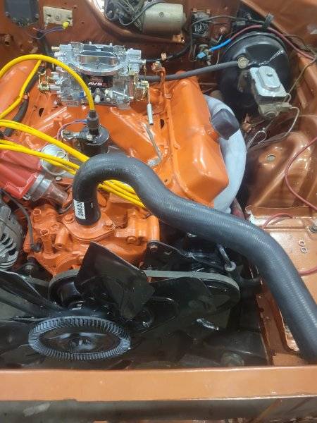

Does anyone have a source and correct part number for radiator hoses? 69 coronet rt, radiator connections are upper on passenger side lower on driver side.

Go back to Rock Auto. Continental 60659 is lower, 60664 is upper, and 60621 is AC upper. The 60664 and 60621 are completely interchangeable. Most use the 60664 upper, but the 60621 is a nice hose and fits well, just routed a little different. You'll have to do the part number search for the 60664, as it doesn't come up for your R/T option. Continental is previously Goodyear brand-good hoses. PM sent.
