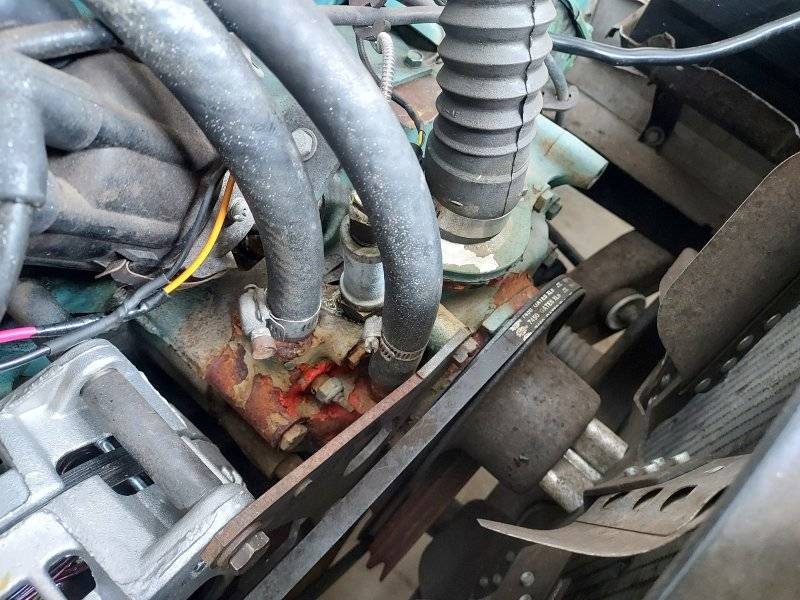

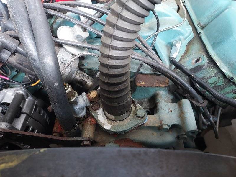

Maybe this might help. The previous owner put a T fitting next to the thermostat housing. The probe for the gauge and the sensor for the throttle body are both screwed into it. I also noticed there is, what looks like, a coolant temp sensor in the front of the housing. Could it just be the location of the probe isn't good? With two different gauges and two thermostats not producing different results I'm inclined to think either the probe location isn't good or this thing just cools too much with the fan constantly running.
With the thermostat closed the cooling system is in closed loop. It is not using the radiator. It does not even care if there is a fan or radiator. The coolant is sitting within the block until the thermostat is open.
Stupid question but the thermostat does go in with the dome facing up towards the hose, right?
Spring side down into the housing.
When you say down into the housing... the housing is what is bolted to the top of the block which means the thermostat spring would be point upwards. So does the spring side go down into the block or up into the housing?
Down that means pointing down into the housing/water pump housing. Don't you have a FSM?
