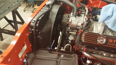

Do you have a cooling issue with the radiator you pulled out of your '70? I'm assuming it was a 22".
Dan
I'm not sure if it's a 22 or 26, I'm not at home right now so I can't go measure it but I think it's a 22. And the only cooling issues I've had were when the lower hose sprung a leak. After I went through all the headaches of getting a new hose on there I figured I'd pull it out and get it reconditioned and put the shroud back on when I put the radiator back in.
IF everything is working right, and you don't have A/C (or a 4-speed), then a 22" would work just fine. But most times not everything is working perfectly and a 26" gets you a bit more margin. On my '68 383 4-bbl 4-spd I have the factory correct 22". The gentleman I bought if from was using it with his 440. In Florida. Worked just fine for him.
Dan
I have a 26 in my 440. When I restored the car I had the radiator triple cored. Fan shroud went back on just fine. I don't have the clearance I used to - but it's enough for it to work just fine.
Done
Why where you talked out of a re-core?
If it was working for you, I'd just re-core it and install the shroud.It may not even need a re-core, just a good flush.
I have a 22" with an added shroud on my 383 and have no problems with it.
If the tanks are in good shape, no cracks or weak spots, then it may only need boiled and rodded to clean out any crap in the core. If its got bent fins, and you want to have it recored, go for it, unless they can comb it out!
